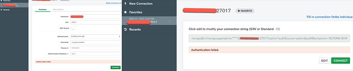

If you can connect with myusername and mypassword using mongosh then the server is okay and the user is okay. So it you cannot connect via Compass or API then there is something you are doing wrong. For example, do you use
in Compass or the text between the double quotes? Do you really use braces around my_hostname or not? The value of host_name must match the bindIp from your configuration file. Since you
then may be both myhostname and {myhostname} are wrong in you connection string. Because, if I remember correctly, by default mongod only listen to 127.0.0.1 or localhost. Post screenshot that shows how you connect with mongosh. Most likely you simply type mongosh so you connect to localhost:27017 rather than {myhostname}:27017.
The only thing I can see is that you are most likely trying to connect to a different mongod.
I think that what ever address you are specifying in Compass (redacted in red) is not routed to the same host as your local host. Try localhost in Compass rather than the other address you are hiding.
@steevej mongod is installed on one of the RHEL server. It’s not my localhost. I am using the IP for RHEL server. I can connect compass to the same IP if I disable security in mongo.conf
Then the user is you are trying to connect with is not configured correctly on the RHEL server. So I wonder why you bother showing us that you can connect with that user on your local host. Unless of course, you are remotely connected to your RHEL server. You need to show us that you can connect with mongo or mongosh from the same machine that you try to connect with Compass.

You are right i get empty list when i switch to admin DB. But get bunch of list of users without doing switch. So I wonder where are these users getting created?
I am able to connect now, thanks @steevej . But i did not get even after mentioning to create users in specific DB why the users got created in test DB
Users are created in the current database. When you connect with mongo and mongosh the current database is test. To create the users in the admin you have to run the command use admin first.
