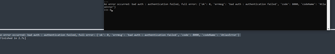

I keep getting this error in sublime.
As you’re not showing how you authenticate (hide passwords please) it’s hard to say what went wrong.
i changed the database password to make sure, but it didn’t work.
bad auth means wrong combination of user id & pwd
Are you giving correct username & password?

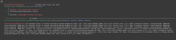

i tried using google colab but give me error SSL certification. In sublime it gives me error bad auth same goes with python in my local
error in colab:
in sublime and python local :

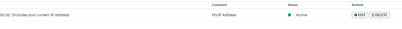

Have you whitelisted your IP? or allow access from anywhere under Network security in Atlas
sorry, is this what you mean?
Yes
try 0.0.0.0/0 and see if it works or not
Also is your port 27017 open?
yes my port 27017 is open. added 0.0.0.0/0 in network access but still doesn’t work… :///
