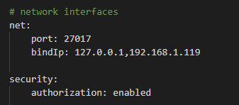

The fact that the introductory message when login on localhost(127.0.0.1) mentionned that “Access control is not enabled” is indeed strange. In my mongod.conf, i have security authorization = enabled.

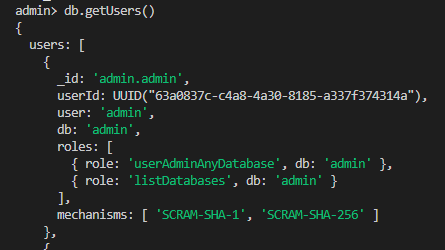

The other weird thing is that on localhost, when i request the list of db users, i can see my admin user in the admin database. However, when login on 192…, when i request the list of users and roles, i see no users (see attachments).

  • mongod_conf.png → see binIp, port and authorization
  • mogosh_admin_user_locahost.png → details of admin user when login on localhost

mongod_conf
mongosh_admin_user_localhost
