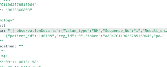

i have imported a json but after importing data inside array is saved as string ,how to convert it into Array eg(userdetails:"[{array with 20-30 fields}]" and i am unable to use mongoimport it is thorwing error

What do you think we can do with an image?

"id": "18616",
"patient_id": "146708",
"sub_user_id": "0",
"app_id": "0",
"ziffy_code": "Ziffy_Test_202",
"doctor_name": "self",
"token": "AA947C11962378516064",
"mobile_number": "9623366803",
"status": null,
"module": "Pathology",
"dicompath": null,
"pathology_data": "[{\"observationDetails\":{\"Value_type\":\"NM\",\"Sequence_No\":\"1\",\"Result_units_of_measurement\":\"-\",\"Observation_value\":\"CLEAR\",\"Result_unit_reference_range\":\"Clear\",\"Effective_date_of_last_normal_observation\":\"\",\"Observation_identifier\":{\"Observation_Coding_System\":\"Ziffy_Test_202\",\"Observation_Text\":\"APPEARANCE\",\"Observation_Test_id\":\"Ziffy_Test_202\"},\"Observation_result_status\":\"F\",\"Abnormal_flags\":\"H\"},\"token\":\"AA947C11962378516064\"},{\"observationDetails\":{\"Value_type\":\"NM\",\"Sequence_No\":\"1\",\"Result_units_of_measurement\":\"-\",\"Observation_value\":\"ABSENT\",\"Result_unit_reference_range\":\"Absent\",\"Effective_date_of_last_normal_observation\":\"\",\"Observation_identifier\":{\"Observation_Coding_System\":\"Ziffy_Test_202\",\"Observation_Text\":\"BACTERIA\",\"Observation_Test_id\":\"Ziffy_Test_202\"},\"Observation_result_status\":\"F\",\"Abnormal_flags\":\"H\"},\"token\":\"AA947C11962378516064\"},{\"observationDetails\":{\"Value_type\":\"NM\",\"Sequence_No\":\"1\",\"Result_units_of_measurement\":\"-\",\"Observation_value\":\"ABSENT\",\"Result_unit_reference_range\":\"Absent\",\"Effective_date_of_last_normal_observation\":\"\",\"Observation_identifier\":{\"Observation_Coding_System\":\"Ziffy_Test_202\",\"Observation_Text\":\"BILE PIGMENT\",\"Observation_Test_id\":\"Ziffy_Test_202\"},\"Observation_result_status\":\"F\",\"Abnormal_flags\":\"H\"},\"token\":\"AA947C11962378516064\"},{\"observationDetails\":{\"Value_type\":\"NM\",\"Sequence_No\":\"1\",\"Result_units_of_measurement\":\"-\",\"Observation_value\":\"ABSENT\",\"Result_unit_reference_range\":\"Absent\",\"Effective_date_of_last_normal_observation\":\"\",\"Observation_identifier\":{\"Observation_Coding_System\":\"Ziffy_Test_202\",\"Observation_Text\":\"BILE SALT\",\"Observation_Test_id\":\"Ziffy_Test_202\"},\"Observation_result_status\":\"F\",\"Abnormal_flags\":\"H\"},\"token\":\"AA947C11962378516064\"},{\"observationDetails\":{\"Value_type\":\"NM\",\"Sequence_No\":\"1\",\"Result_units_of_measurement\":\"-\",\"Observation_value\":\"ABSENT\",\"Result_unit_reference_range\":\"Absent\",\"Effective_date_of_last_normal_observation\":\"\",\"Observation_identifier\":{\"Observation_Coding_System\":\"Ziffy_Test_202\",\"Observation_Text\":\"CASTS\",\"Observation_Test_id\":\"Ziffy_Test_202\"},\"Observation_result_status\":\"F\",\"Abnormal_flags\":\"H\"},\"token\":\"AA947C11962378516064\"},{\"observationDetails\":{\"Value_type\":\"NM\",\"Sequence_No\":\"1\",\"Result_units_of_measurement\":\"-\",\"Observation_value\":\"PALE YELLOW\",\"Result_unit_reference_range\":\"Pale Yellow\",\"Effective_date_of_last_normal_observation\":\"\",\"Observation_identifier\":{\"Observation_Coding_System\":\"Ziffy_Test_202\",\"Observation_Text\":\"COLOUR\",\"Observation_Test_id\":\"Ziffy_Test_202\"},\"Observation_result_status\":\"F\",\"Abnormal_flags\":\"H\"},\"token\":\"AA947C11962378516064\"},{\"observationDetails\":{\"Value_type\":\"NM\",\"Sequence_No\":\"1\",\"Result_units_of_measurement\":\"-\",\"Observation_value\":\"ABSENT\",\"Result_unit_reference_range\":\"Absent\",\"Effective_date_of_last_normal_observation\":\"\",\"Observation_identifier\":{\"Observation_Coding_System\":\"Ziffy_Test_202\",\"Observation_Text\":\"CRYSTALS\",\"Observation_Test_id\":\"Ziffy_Test_202\"},\"Observation_result_status\":\"F\",\"Abnormal_flags\":\"H\"},\"token\":\"AA947C11962378516064\"},{\"observationDetails\":{\"Value_type\":\"NM\",\"Sequence_No\":\"1\",\"Result_units_of_measurement\":\"-\",\"Observation_value\":\"1-2\",\"Result_unit_reference_range\":\"0-4\",\"Effective_date_of_last_normal_observation\":\"\",\"Observation_identifier\":{\"Observation_Coding_System\":\"Ziffy_Test_202\",\"Observation_Text\":\"EPITHELIAL CELLS\",\"Observation_Test_id\":\"Ziffy_Test_202\"},\"Observation_result_status\":\"F\",\"Abnormal_flags\":\"N\"},\"token\":\"AA947C11962378516064\"},{\"observationDetails\":{\"Value_type\":\"NM\",\"Sequence_No\":\"1\",\"Result_units_of_measurement\":\"mg\\/l\",\"Observation_value\":\"10\",\"Result_unit_reference_range\":\"< 20\",\"Effective_date_of_last_normal_observation\":\"\",\"Observation_identifier\":{\"Observation_Coding_System\":\"Ziffy_Test_202\",\"Observation_Text\":\"MICROALBUMIN\",\"Observation_Test_id\":\"Ziffy_Test_202\"},\"Observation_result_status\":\"F\",\"Abnormal_flags\":\"H\"},\"token\":\"AA947C11962378516064\"},{\"observationDetails\":{\"Value_type\":\"NM\",\"Sequence_No\":\"1\",\"Result_units_of_measurement\":\"-\",\"Observation_value\":\"ABSENT\",\"Result_unit_reference_range\":\"Absent\",\"Effective_date_of_last_normal_observation\":\"\",\"Observation_identifier\":{\"Observation_Coding_System\":\"Ziffy_Test_202\",\"Observation_Text\":\"MUCUS\",\"Observation_Test_id\":\"Ziffy_Test_202\"},\"Observation_result_status\":\"F\",\"Abnormal_flags\":\"H\"},\"token\":\"AA947C11962378516064\"},{\"observationDetails\":{\"Value_type\":\"NM\",\"Sequence_No\":\"1\",\"Result_units_of_measurement\":\"-\",\"Observation_value\":\"ABSENT\",\"Result_unit_reference_range\":\"Absent\",\"Effective_date_of_last_normal_observation\":\"\",\"Observation_identifier\":{\"Observation_Coding_System\":\"Ziffy_Test_202\",\"Observation_Text\":\"NITRITE\",\"Observation_Test_id\":\"Ziffy_Test_202\"},\"Observation_result_status\":\"F\",\"Abnormal_flags\":\"H\"},\"token\":\"AA947C11962378516064\"},{\"observationDetails\":{\"Value_type\":\"NM\",\"Sequence_No\":\"1\",\"Result_units_of_measurement\":\"-\",\"Observation_value\":\"ABSENT\",\"Result_unit_reference_range\":\"Absent\",\"Effective_date_of_last_normal_observation\":\"\",\"Observation_identifier\":{\"Observation_Coding_System\":\"Ziffy_Test_202\",\"Observation_Text\":\"PARASITE\",\"Observation_Test_id\":\"Ziffy_Test_202\"},\"Observation_result_status\":\"F\",\"Abnormal_flags\":\"H\"},\"token\":\"AA947C11962378516064\"},{\"observationDetails\":{\"Value_type\":\"NM\",\"Sequence_No\":\"1\",\"Result_units_of_measurement\":\"-\",\"Observation_value\":\"5\",\"Result_unit_reference_range\":\"5 - 8\",\"Effective_date_of_last_normal_observation\":\"\",\"Observation_identifier\":{\"Observation_Coding_System\":\"Ziffy_Test_202\",\"Observation_Text\":\"PH\",\"Observation_Test_id\":\"Ziffy_Test_202\"},\"Observation_result_status\":\"F\",\"Abnormal_flags\":\"N\"},\"token\":\"AA947C11962378516064\"},{\"observationDetails\":{\"Value_type\":\"NM\",\"Sequence_No\":\"1\",\"Result_units_of_measurement\":\"Cells\\/ul*\",\"Observation_value\":\"ABSENT\",\"Result_unit_reference_range\":\"Absent\",\"Effective_date_of_last_normal_observation\":\"\",\"Observation_identifier\":{\"Observation_Coding_System\":\"Ziffy_Test_202\",\"Observation_Text\":\"RED BLOOD CELLS\",\"Observation_Test_id\":\"Ziffy_Test_202\"},\"Observation_result_status\":\"F\",\"Abnormal_flags\":\"H\"},\"token\":\"AA947C11962378516064\"},{\"observationDetails\":{\"Value_type\":\"NM\",\"Sequence_No\":\"1\",\"Result_units_of_measurement\":\"-\",\"Observation_value\":\"1.01\",\"Result_unit_reference_range\":\"1.003-1.030\",\"Effective_date_of_last_normal_observation\":\"\",\"Observation_identifier\":{\"Observation_Coding_System\":\"Ziffy_Test_202\",\"Observation_Text\":\"SPECIFIC GRAVITY\",\"Observation_Test_id\":\"Ziffy_Test_202\"},\"Observation_result_status\":\"F\",\"Abnormal_flags\":\"N\"},\"token\":\"AA947C11962378516064\"},{\"observationDetails\":{\"Value_type\":\"NM\",\"Sequence_No\":\"1\",\"Result_units_of_measurement\":\"mg\\/dl\",\"Observation_value\":\"ABSENT\",\"Result_unit_reference_range\":\"Absent\",\"Effective_date_of_last_normal_observation\":\"\",\"Observation_identifier\":{\"Observation_Coding_System\":\"Ziffy_Test_202\",\"Observation_Text\":\"URINARY BILIRUBIN\",\"Observation_Test_id\":\"Ziffy_Test_202\"},\"Observation_result_status\":\"F\",\"Abnormal_flags\":\"H\"},\"token\":\"AA947C11962378516064\"},{\"observationDetails\":{\"Value_type\":\"NM\",\"Sequence_No\":\"1\",\"Result_units_of_measurement\":\"mg\\/dl\",\"Observation_value\":\"ABSENT\",\"Result_unit_reference_range\":\"Absent\",\"Effective_date_of_last_normal_observation\":\"\",\"Observation_identifier\":{\"Observation_Coding_System\":\"Ziffy_Test_202\",\"Observation_Text\":\"URINARY GLUCOSE\",\"Observation_Test_id\":\"Ziffy_Test_202\"},\"Observation_result_status\":\"F\",\"Abnormal_flags\":\"H\"},\"token\":\"AA947C11962378516064\"},{\"observationDetails\":{\"Value_type\":\"NM\",\"Sequence_No\":\"1\",\"Result_units_of_measurement\":\"Cells\\/ul*\",\"Observation_value\":\"ABSENT\",\"Result_unit_reference_range\":\"Absent\",\"Effective_date_of_last_normal_observation\":\"\",\"Observation_identifier\":{\"Observation_Coding_System\":\"Ziffy_Test_202\",\"Observation_Text\":\"URINARY LEUCOCYTES (PUS CELLS)\",\"Observation_Test_id\":\"Ziffy_Test_202\"},\"Observation_result_status\":\"F\",\"Abnormal_flags\":\"H\"},\"token\":\"AA947C11962378516064\"},{\"observationDetails\":{\"Value_type\":\"NM\",\"Sequence_No\":\"1\",\"Result_units_of_measurement\":\"mg\\/dl\",\"Observation_value\":\"ABSENT\",\"Result_unit_reference_range\":\"Absent\",\"Effective_date_of_last_normal_observation\":\"\",\"Observation_identifier\":{\"Observation_Coding_System\":\"Ziffy_Test_202\",\"Observation_Text\":\"URINARY PROTEIN\",\"Observation_Test_id\":\"Ziffy_Test_202\"},\"Observation_result_status\":\"F\",\"Abnormal_flags\":\"H\"},\"token\":\"AA947C11962378516064\"},{\"observationDetails\":{\"Value_type\":\"NM\",\"Sequence_No\":\"1\",\"Result_units_of_measurement\":\"Cells\\/ul*\",\"Observation_value\":\"ABSENT\",\"Result_unit_reference_range\":\"Absent\",\"Effective_date_of_last_normal_observation\":\"\",\"Observation_identifier\":{\"Observation_Coding_System\":\"Ziffy_Test_202\",\"Observation_Text\":\"URINE BLOOD\",\"Observation_Test_id\":\"Ziffy_Test_202\"},\"Observation_result_status\":\"F\",\"Abnormal_flags\":\"H\"},\"token\":\"AA947C11962378516064\"},{\"observationDetails\":{\"Value_type\":\"NM\",\"Sequence_No\":\"1\",\"Result_units_of_measurement\":\"mg\\/dl\",\"Observation_value\":\"ABSENT\",\"Result_unit_reference_range\":\"Absent\",\"Effective_date_of_last_normal_observation\":\"\",\"Observation_identifier\":{\"Observation_Coding_System\":\"Ziffy_Test_202\",\"Observation_Text\":\"URINE KETONE\",\"Observation_Test_id\":\"Ziffy_Test_202\"},\"Observation_result_status\":\"F\",\"Abnormal_flags\":\"H\"},\"token\":\"AA947C11962378516064\"},{\"observationDetails\":{\"Value_type\":\"NM\",\"Sequence_No\":\"1\",\"Result_units_of_measurement\":\"mg\\/dl\",\"Observation_value\":\"< 0.2\",\"Result_unit_reference_range\":\"<=0.2\",\"Effective_date_of_last_normal_observation\":\"\",\"Observation_identifier\":{\"Observation_Coding_System\":\"Ziffy_Test_202\",\"Observation_Text\":\"UROBILINOGEN\",\"Observation_Test_id\":\"Ziffy_Test_202\"},\"Observation_result_status\":\"F\",\"Abnormal_flags\":\"H\"},\"token\":\"AA947C11962378516064\"},{\"observationDetails\":{\"Value_type\":\"NM\",\"Sequence_No\":\"1\",\"Result_units_of_measurement\":\"mL\",\"Observation_value\":\"3\",\"Result_unit_reference_range\":\"-\",\"Effective_date_of_last_normal_observation\":\"\",\"Observation_identifier\":{\"Observation_Coding_System\":\"Ziffy_Test_202\",\"Observation_Text\":\"VOLUME\",\"Observation_Test_id\":\"Ziffy_Test_202\"},\"Observation_result_status\":\"F\",\"Abnormal_flags\":\"H\"},\"token\":\"AA947C11962378516064\"},{\"observationDetails\":{\"Value_type\":\"NM\",\"Sequence_No\":\"1\",\"Result_units_of_measurement\":\"-\",\"Observation_value\":\"ABSENT\",\"Result_unit_reference_range\":\"Absent\",\"Effective_date_of_last_normal_observation\":\"\",\"Observation_identifier\":{\"Observation_Coding_System\":\"Ziffy_Test_202\",\"Observation_Text\":\"YEAST\",\"Observation_Test_id\":\"Ziffy_Test_202\"},\"Observation_result_status\":\"F\",\"Abnormal_flags\":\"H\"},\"token\":\"AA947C11962378516064\"}]",
"content_data": "{\"patient_id\":\"146708\",\"reg_id\":\"0\",\"token\":\"AA947C11962378516064\",\"patient_mobile\":\"9623366803\",\"test_zippycode\":\"Ziffy_Test_202\",\"doctor_name\":\"self\",\"status\":\"Authorise\",\"Module\":\"Pathology\" ,\"DicomPath\":\"File Not Found\",\"sct\":\"11 Sep 2022 06:00\",\"rrt\":\"11 Sep 2022 14:12\",\"labcode\":\"1109071699/AA947\",\"sample_type\":\"URINE\",\"srt\":\"11 Sep 2022 12:56\",\"Testgrp\":\"COMPLETE URINE ANALYSIS\"}",
