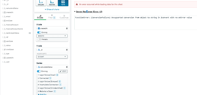

Hi, i was trying to investigate the error on the chart scrapping while try to binning with parameter given from my company on MonogDB Chart, it shows an error while loading which stated conversionFailure attached on the screenshot. The chart was shown when i put a field to series, but when i turned on binning it show the error. Idk but the other chart showing just fine. Any advice regarding this issues?
the value expression on that field (calculated status) =
Looking at your chart definition, I suspect the issue is that the calculated field is returning an object value for at least one document.
We’ll see if we can add some more protection for this case in our string binning logic, but in the meantime you should be able to fix it by wrapping your calculated field in a $convert statement including an onError value.

so an [object object] on the chart parameter shows before i use the binning logic, this should be the one who made the “error:13 unsupported conversion from object to string” on the first place
Looking at your conversion, I suspect the issue is that the object value is in at last one document for the status field, but your converion is for the lastScraperStatus. Given your data is not showing either of your error messages, I suspect that means there are no values in lastScraperStatus that are failing to convert. Have you tried doing the $convert on the $status value in your else clause?

I’ve already tried doing the $convert on the $status value in else clause and it still showing the same error object to string which "FunctionError: (ConversionFailure) Unsupported conversion from object to string in $convert with no onError value"
so i think is it better to use it on the lastscraperstatus isnt it?
I’m not sure what your data looks like, but given Binning is failing because some of your values are objects, I suspect the safest thing to do would be to convert both values to strings with the onError block. So something like this:
