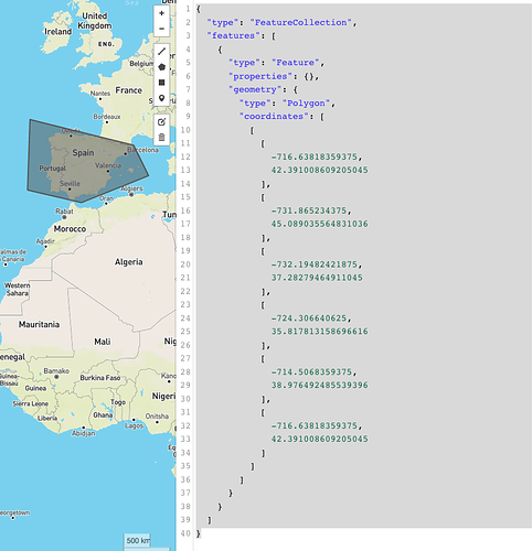

in it they went to http://geojson.io to create a JSON with the coordinates of Scotland to use in an Aggregation Pipeline in MONGOBB COMPASS.
I created a Polygon with the Spain and Portugal countries.

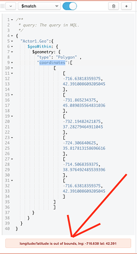

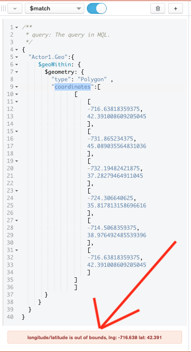

When I create the $match Stage in MONGOBB COMPASS an error message is shows saying:
longitude/latitude is out of bounds, lng: -716.638 lat: 42.391

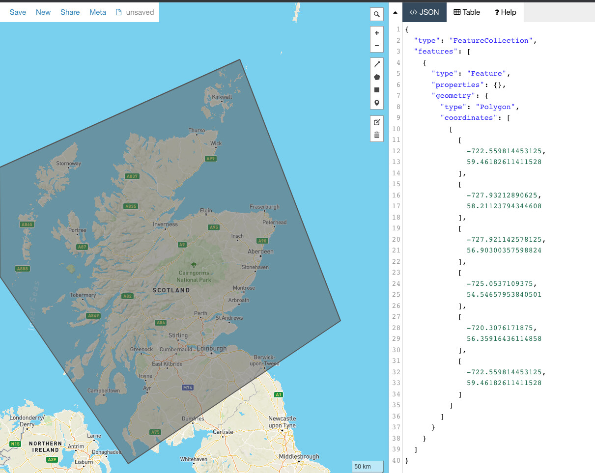

I also tried create a polygon of Scotland, but the coordinates that I get are very different to what they get in the video.
I get values around -720 and they get values between -1 and -6 for a similar region.
What is wrong in http://geojson.io ?

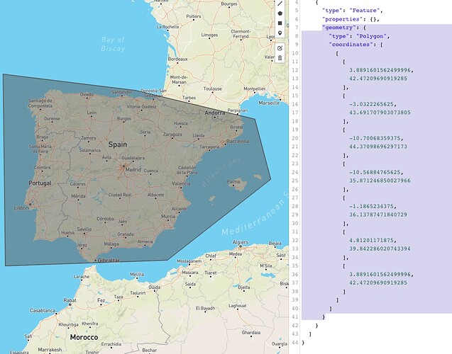

Hi @Manuel_Martin ,
I’m afraid I have no idea why geojson.io is giving you those numbers! I’ve just created a similar polygon and got the following numbers:
"geometry": {
"type": "Polygon",
"coordinates": [
3.8891601562499996,
42.47209690919285
-3.0322265625,
43.691707903073805
-10.70068359375,
44.37098696297173
-10.56884765625,
35.871246850027966
-1.1865234375,
36.13787471840729
4.81201171875,
39.842286020743394
3.8891601562499996,
42.47209690919285
Hope this helps!
Mark
In MongoDB GeoJSON points are Longitude then latitude, same as in geojson.io - so the pairs are in the correct order.
The problem here is that -720 isn’t a valid longitude or latitude value - it’s just nonsense.
Valid longitude values are between -180 and 180 , both inclusive.
Valid latitude values are between -90 and 90 , both inclusive.
