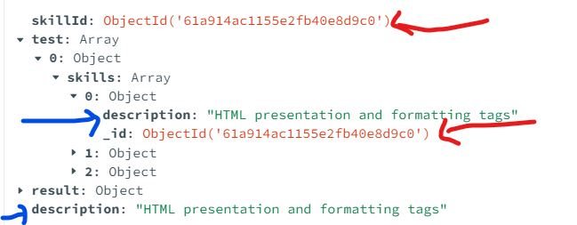

I want a result that does the following thing it matches the Id of skillId with test.skills._id and return its description i wrote the above map but it doesn’t return anything null can someone suggest me proper way of query nested arrays

Hi, steevej thank you for the response. I figured out how to get the desired output. I was looking for a document like this
The aggregation I wrote seems so messy

can you please suggest me a more optimized way for achieving the description.
