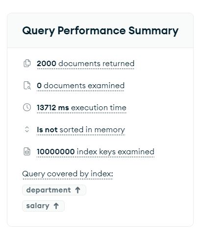

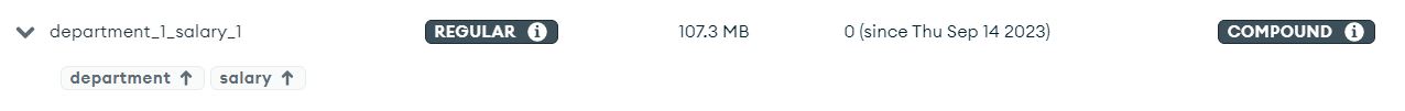

0 index keys examined while I created an index department/salary and the query is to slow
Query Performance Summary
Do you have an idea ?

Yes I have an index
With $sort stage, the query uses the index but it is not really faster
Slower than Postgres :frowning:
Query Performance Summary with sort
Without the $sort stage, the execution time is nearly the same
Query Performance Summary without sort
Do you think a search index could improve the query ?

I used Mongo Compass to connect to a M20 cluster.
It took about 13s.
Does the execution time give a real information or execution statistics of the query plans ?
Do I need to write some code to execute the query and return the result ?
