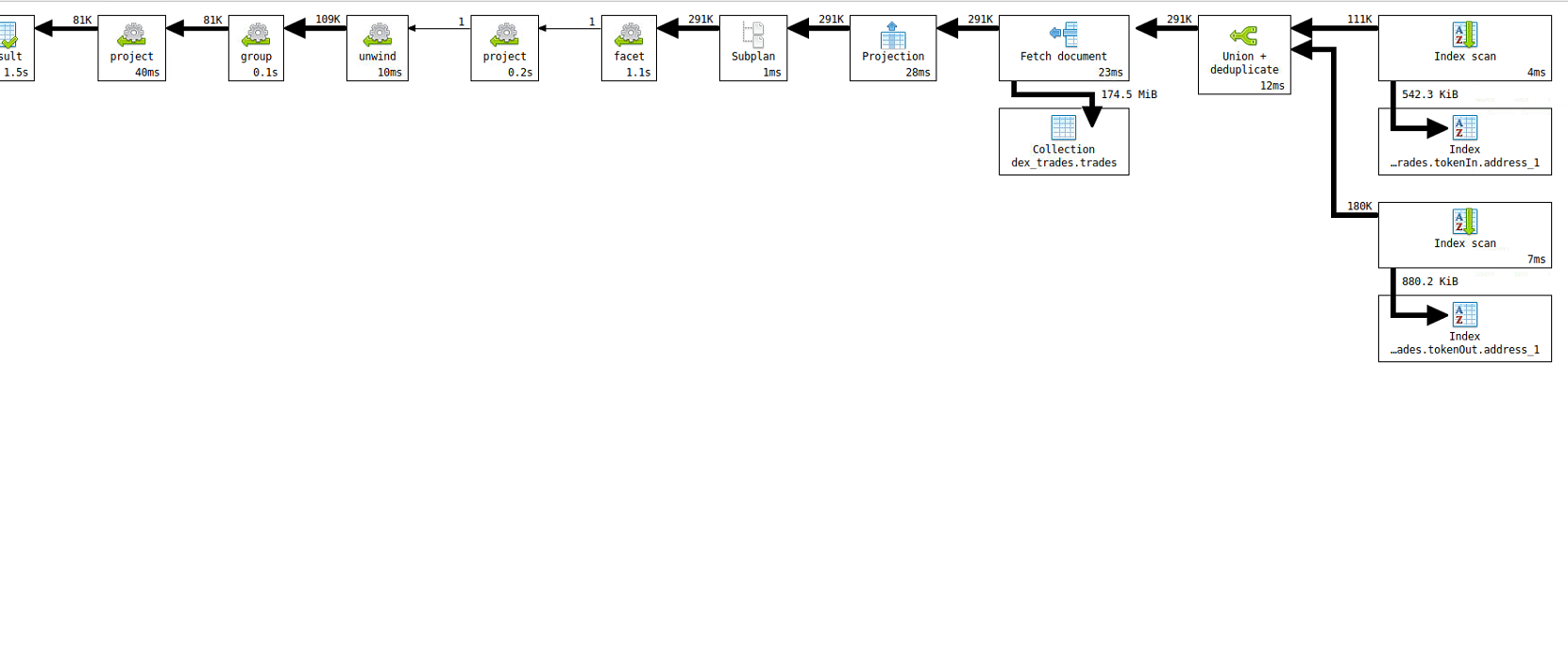

explain (before changes)
    "explainVersion" : "1",
    "stages" : [
            "$cursor" : {
                "queryPlanner" : {
                    "namespace" : "dex_trades.trades",
                    "indexFilterSet" : false,
                    "parsedQuery" : {
                        "$or" : [
                                "tokenIn.address" : {
                                    "$eq" : "0x6982508145454ce325ddbe47a25d4ec3d2311933"
                                "tokenOut.address" : {
                    "queryHash" : "D2428EAE",
                    "planCacheKey" : "D9A6C586",
                    "maxIndexedOrSolutionsReached" : false,
                    "maxIndexedAndSolutionsReached" : false,
                    "maxScansToExplodeReached" : false,
                    "winningPlan" : {
                        "stage" : "SUBPLAN",
                        "inputStage" : {
                            "stage" : "PROJECTION_DEFAULT",
                            "transformBy" : {
                                "amountIn" : NumberInt(1),
                                "amountOut" : NumberInt(1),
                                "taker" : NumberInt(1),
                                "tokenIn.address" : NumberInt(1),
                                "tokenOut.address" : NumberInt(1),
                                "_id" : NumberInt(0)
                            "inputStage" : {
                                "stage" : "FETCH",
                                "inputStage" : {
                                    "stage" : "OR",
                                    "inputStages" : [
                                            "stage" : "IXSCAN",
                                            "keyPattern" : {
                                            "indexName" : "tokenIn.address_1",
                                            "isMultiKey" : false,
                                            "multiKeyPaths" : {
                                                "tokenIn.address" : [
                                            "isUnique" : false,
                                            "isSparse" : false,
                                            "isPartial" : false,
                                            "indexVersion" : NumberInt(2),
                                            "direction" : "forward",
                                            "indexBounds" : {
                                                    "[\"0x6982508145454ce325ddbe47a25d4ec3d2311933\", \"0x6982508145454ce325ddbe47a25d4ec3d2311933\"]"
                                            "stage" : "IXSCAN",
                                            "keyPattern" : {
                                            "indexName" : "tokenOut.address_1",
                                            "multiKeyPaths" : {
                                                "tokenOut.address" : [
                                            "isUnique" : false,
                                            "isSparse" : false,
                                            "indexBounds" : {
                    "rejectedPlans" : [
            "$facet" : {
                "sold" : [
                        "$internalFacetTeeConsumer" : {
                        "$match" : {
                        "$group" : {
                            "_id" : "$taker",
                            "total" : {
                                "$sum" : {
                                    "$multiply" : [
                                        "$amountIn",
                                            "$const" : NumberInt(-1)
                "bought" : [
                        "$match" : {
                        "$group" : {
                            "_id" : "$taker",
                            "total" : {
                                "$sum" : "$amountOut"
            "$project" : {
                "_id" : true,
                "allItem" : {
                    "$setUnion" : [
                        "$sold",
                        "$bought"
                "sold" : "$sold",
                "bought" : "$bought"
            "$unwind" : {
                "path" : "$allItem"
            "$group" : {
                "_id" : "$allItem._id",
                "total" : {
                    "$sum" : "$allItem.total"
            "$project" : {
                "wallet" : "$_id",
                "amount" : "$total",
                "sold" : "$sold",
                "bought" : "$bought",
                "_id" : false
    "serverInfo" : {
        "host" : "DeFiHub",
        "port" : NumberInt(27017),
        "version" : "6.0.8",
        "gitVersion" : "3d84c0dd4e5d99be0d69003652313e7eaf4cdd74"
    "serverParameters" : {
        "internalQueryFacetBufferSizeBytes" : NumberInt(104857600),
        "internalQueryFacetMaxOutputDocSizeBytes" : NumberInt(104857600),
        "internalLookupStageIntermediateDocumentMaxSizeBytes" : NumberInt(104857600),
        "internalDocumentSourceGroupMaxMemoryBytes" : NumberInt(104857600),
        "internalQueryMaxBlockingSortMemoryUsageBytes" : NumberInt(104857600),
        "internalQueryProhibitBlockingMergeOnMongoS" : NumberInt(0),
        "internalQueryMaxAddToSetBytes" : NumberInt(104857600),
        "internalDocumentSourceSetWindowFieldsMaxMemoryBytes" : NumberInt(104857600)
    "command" : {
        "aggregate" : "trades",
        "pipeline" : [
                "$match" : {
                    "$or" : [
                            "tokenOut.address" : "0x6982508145454ce325ddbe47a25d4ec3d2311933"
                            "tokenIn.address" : "0x6982508145454ce325ddbe47a25d4ec3d2311933"
                "$facet" : {
                    "sold" : [
                            "$match" : {
                            "$group" : {
                                "_id" : "$taker",
                                "total" : {
                                    "$sum" : {
                                        "$multiply" : [
                                            NumberInt(-1),
                                            "$amountIn"
                    "bought" : [
                            "$match" : {
                            "$group" : {
                                "_id" : "$taker",
                                "total" : {
                "$project" : {
                    "allItem" : {
                        "$setUnion" : [
                            "$sold",
                            "$bought"
                    "sold" : "$sold",
                "$unwind" : "$allItem"
                "$group" : {
                    "total" : {
                "$project" : {
                    "_id" : NumberInt(0),
                    "wallet" : "$_id",
                    "sold" : "$sold",
        "allowDiskUse" : true,
        "maxTimeMS" : NumberLong(0),
        "cursor" : {
        "$db" : "dex_trades"
    "ok" : 1.0
Nobody has an idea what could be wrong?
