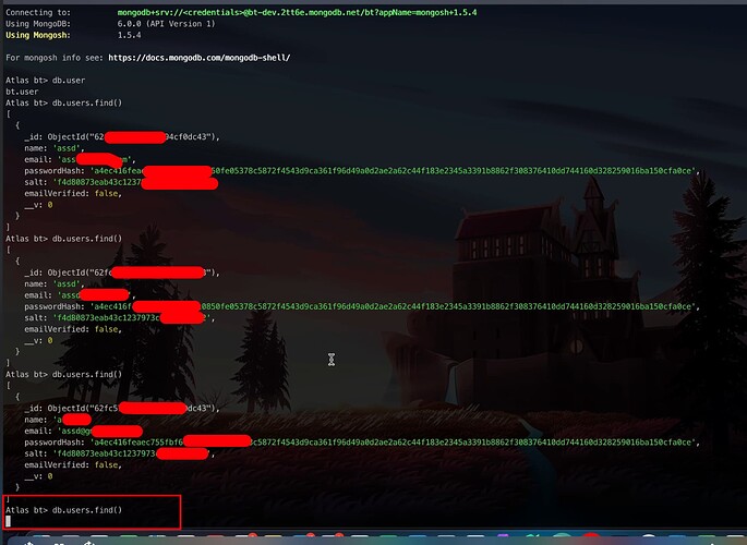

first, i exec ‘mongosh “mongodb+srv://bt-dev.2tt6e.mongodb.net/bt” --apiVersion 1 --username bt’ ,Then I try to query the data, which is normal (eg: db.users.find({})).
Wait for 10 minutes and execute the query statement again. There will be a problem here. It often takes 1 minute to return the result, and sometimes it is directly stuck and nothing is returned.

All time periods noted in 2. did not produce a delayed response. However, I did on one occasion get a “connection closed” error but was not able to reproduce this again in future.
One thing I did note that was different was the MongoDB version in use (my testing was done using 6.0.1). I was not able to test using 6.0.0 noted in your screenshot.
