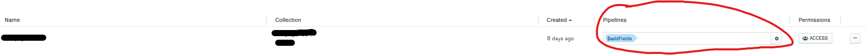

Thanks for your help, i have find where to add my pipeline :slight_smile:
