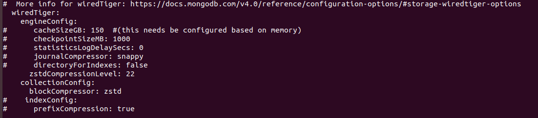

I have compared same data restoration to MongoDB 4.2, 5.0 (with compression level 6-default, 10, 15 and 22), but i found no data compression is found:
I have set zstd and block compreser level as expaling in config files as:
Anything I am missing here?
