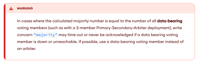

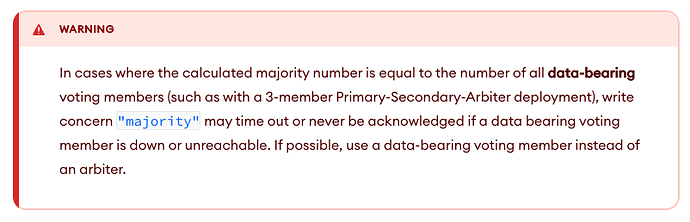

There is also a warning under Calculating Majority for Write Concern:
There is more detail in the documentation links above, but in general it is better to avoid the use of arbiters where possible.
