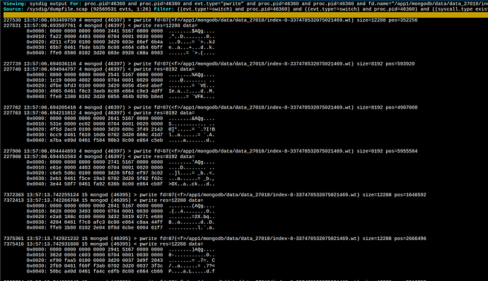

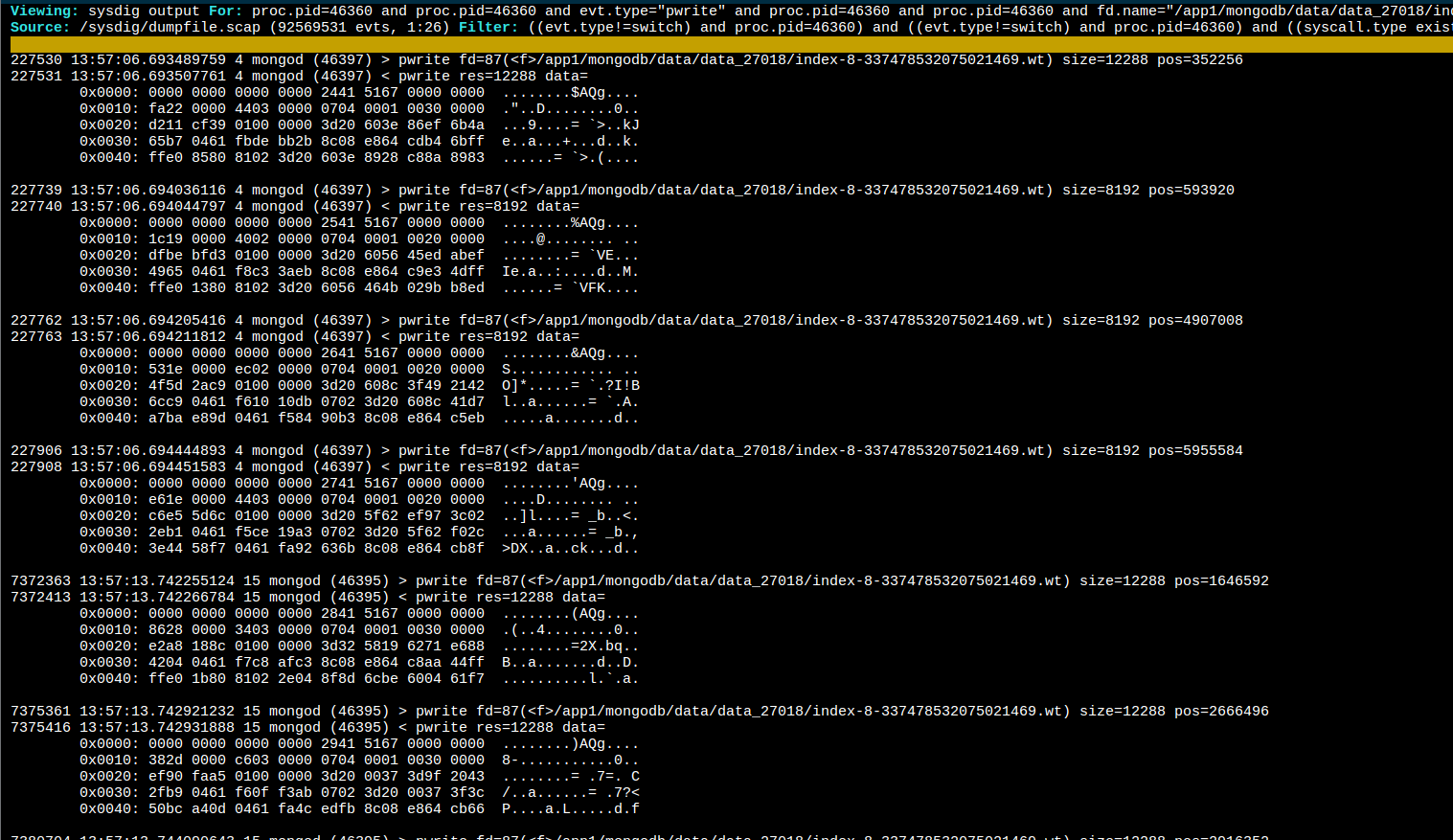

I have been dealing with an unusual performance issue in MongoDB. To investigate the root cause of the performance problem, I used sysdig to record the system conditions during the time of the issue. The problem occurs every Saturday around 11:00 AM, when disk I/O becomes highly busy, reaching over 100%. Since the default logs didn’t provide any insights into the issue, I resorted to using sysdig to capture the system conditions during the faulty period. Initially, I wanted to examine system calls like pwrite or write to see what data was being written. However, I realized that the data written to WiredTiger (wt) is compressed or encrypted and cannot be directly read. Is there a way to convert this text into readable content? Additionally, I’m curious about the compression or encryption algorithms used in this process.
