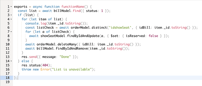

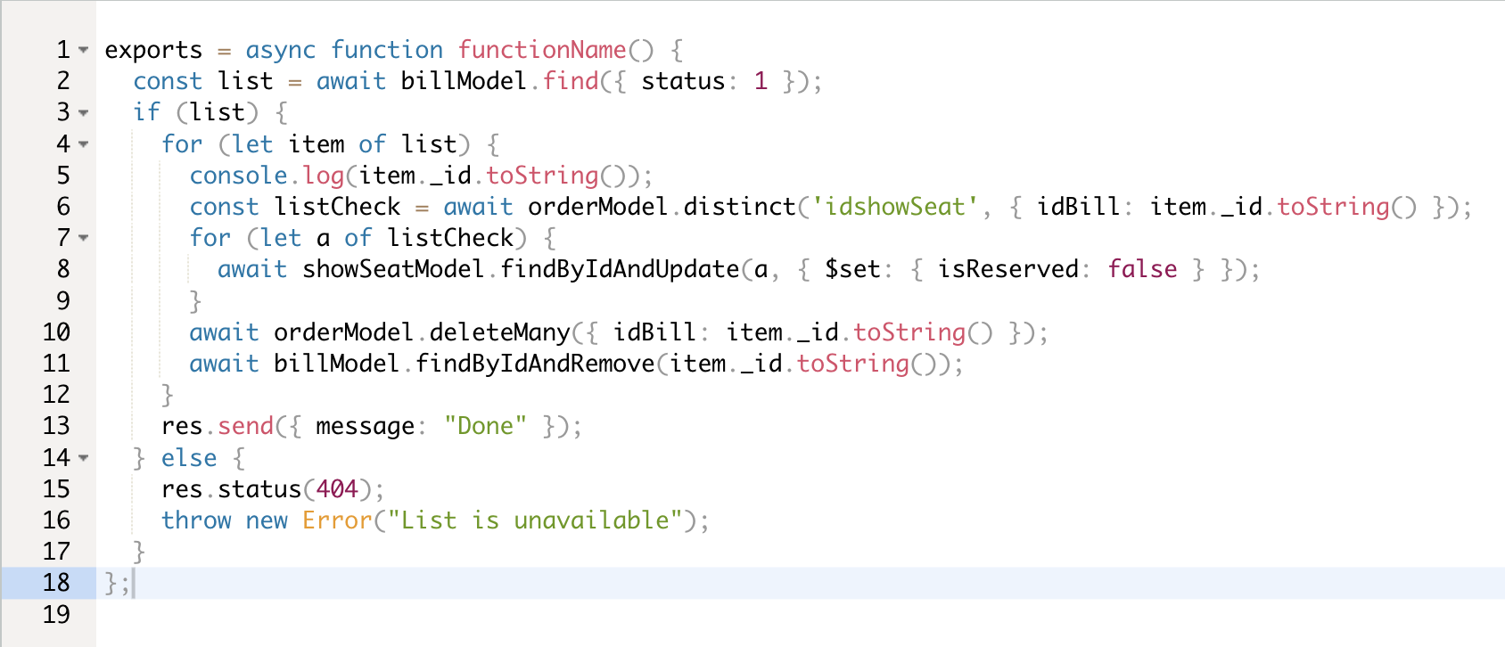

Hi @Kushagra_Kesav ,
I also had the same problem as above. I have a function that needs it to run on a schedule and I found a scheduled trigger
here is the code i want to convert it on Imgur: The magic of the Internet and you will see “async” or “await”. It helps me to process this function on this line when it’s done, the system will let me run the next function on the next line to explain why I need to do it. I would appreciate you very much if you have some ideas or solutions for this. I look forward to hearing your thoughts. Thank you so much in advance
Hey @Phan_Thanh_Lam_N_A,
Apologies for the late response.
I tried to create a trigger using the code you provided, and it worked fine for me. I didn’t encounter any errors related to 'async functions' is only available in es8 (use 'esversion: 8'). If you’re experiencing an error message, could you please share the exact message or provide more details about the specific issue you’re encountering while creating the trigger?
Additionally, if you’re facing challenges with using async/await, you can consider using promises as a workaround.
Could you please elaborate or give an example of the scenario that you have in mind?
