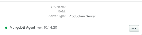

This is what I got on OpsManager UI (Automation is missing)
enter image description here

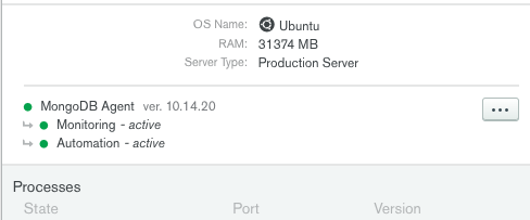

This is what I expect to get
