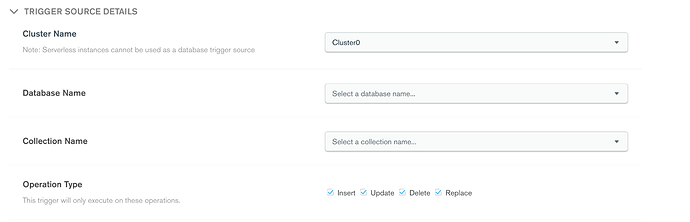

I am not seeing any database or collection set. Does something show up there for you?
Yes, it’s filled in appropriately with the db name and collection. Not sure why it didn’t populate for you, but I don’t understand how the permissions would work for Mongo employees. Can DM if you wish - wouldn’t think it’d be good to show our specific details. Same behavior with both triggers in the app btw.
