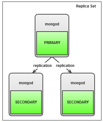

Replica set is a group of mongod instances that host the same data set, means 3 or (any odd numbered upto 50) instance (also called members) running on either same server or different servers.
repset
For more info read here
Whereas cluster just consists of multiple instances and in the context of MongoDB, “cluster” is the word usually used for either a replica set or a sharded cluster.
So, the conclusion is 3 instance means 3 process running on same or different server with separate configuration files is called a replica set. And by saying cluster we are referring to the same replica set.
