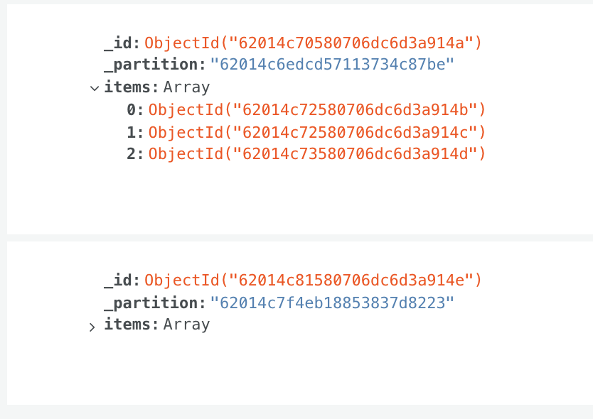

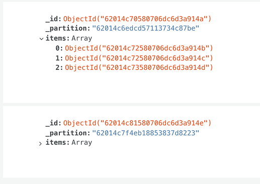

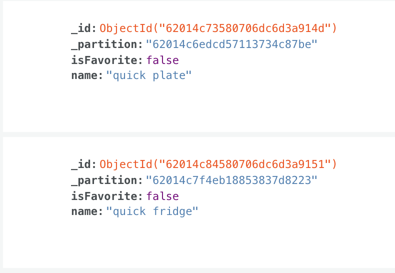

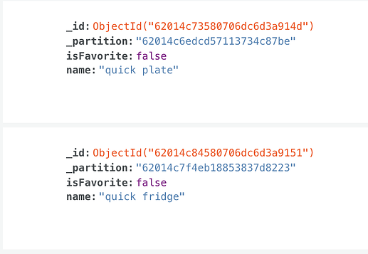

When you see the main UI, there are no items in the view. That’s because we’re using anonymous login, and there won’t be any objects matching this user’s partitionValue - i.e. their user id. When you start creating objects, those objects write to Realm - both on the device, and in the linked database you specified in the Sync configuration. The realm file itself has the partitionValue. The objects that the user writes to the realm file have that partitionValue appended as the partition field you specified in the configuration. If you go look in the linked database, you’ll see both the Group objects and the Item objects contain a field _partition that contains the user ID of the logged-in user who created the objects:
