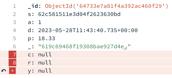

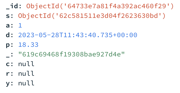

I added an object with optional fields having a nil value. Then I check what it looks like in the MongoDB:
There are c, r, and y optional fields containing nil value and are stored in the MongoDB as nulls. This object size is 111B. Now, I can just manually edit this object in the MongoDB and delete those fields:
The resulting object size is 102B so I just freed ~10% of storage space and everything still works as expected. If I check the object in the iOS app those fields will be nil. So the question is: is it possible to somehow store optional values as “absence of a value” instead of putting null there?
