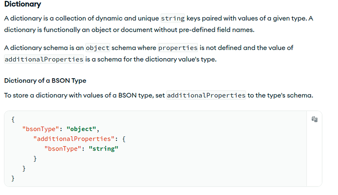

I try to create a schema without predefined names. I found the “dictionary” option on documentation.
but my schema dont work:
“paymentObject”: {
“additionalProperties”: {
“bsonType”: “string”
“bsonType”: “object”

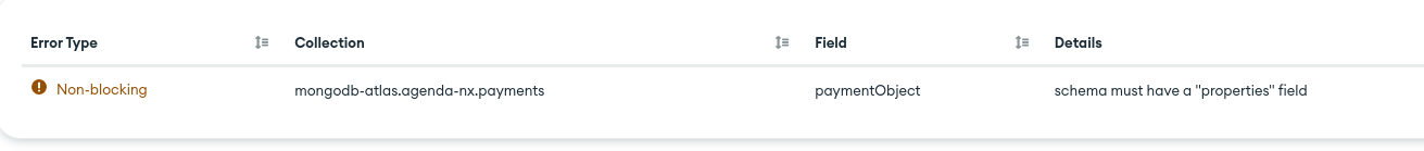

and show the message
What am I doing wrong?

But I still no know why the dictionary no works. Can you explaim to me?
Dictionary doesn’t fit in schema structure available.
If you field type to Object, you will be expected to set keys and their value types within schema definition. Otherwise schema would not compile.
