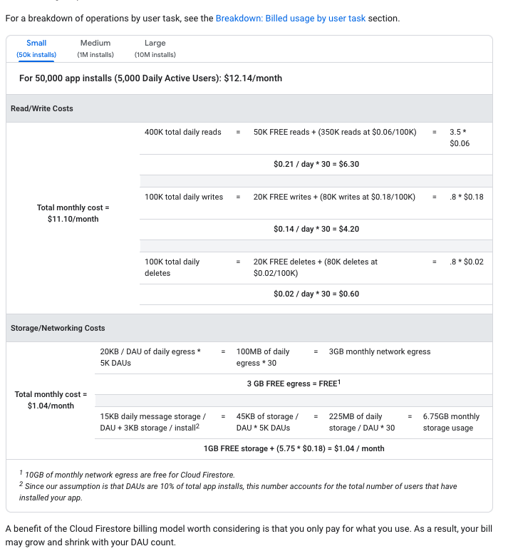

Check out the examples for example mobile product cost:
Firebase Example:

The costs per request seem to be the big differentiator. The free tier seems to be more generous with Firebase as well. Am I missing something or is Realm significantly more costly when compared with Firestore?
