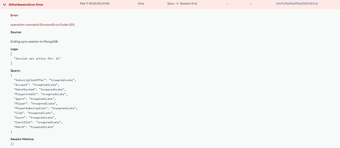

And I didn’t mention it, because I don’t know if it related, but I got this error in the logs for some times.
But I don’t have any error in the phone’s app. I don’t know if it related (if it’s not ignore this, I will create another ticket for it)

I got this error in the logs for some times. But I don’t have any error in the phone’s app.
That error is transient, it usually just means that the device has disconnected from sync.
