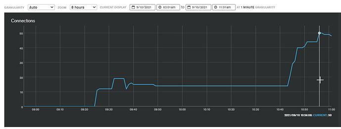

Here is a screenshot of the newly created app as of today 9.10.21
The huge spike is when I logged into my realm app from the browser. It went from 15 to 50 with ONE SINGLE USER!!
