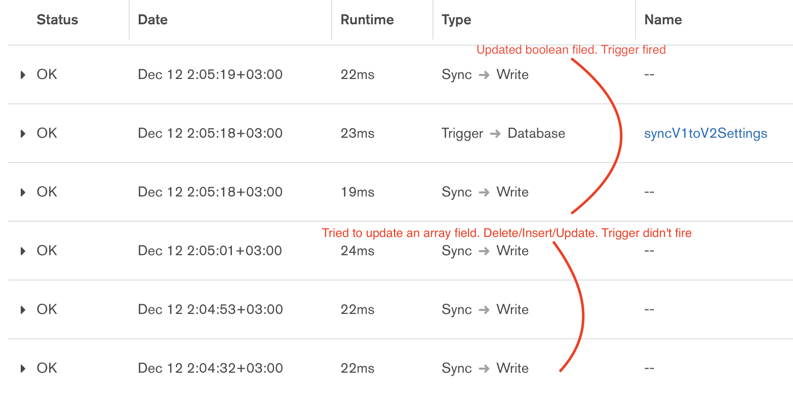

On the other hand, I just tried to play with the trigger and noticed that it doesn’t work when I update a field in the array field. I have object like this:
{ ts: [{ i: ObjectId, t: 1.1 }], e: true }
Logs:
