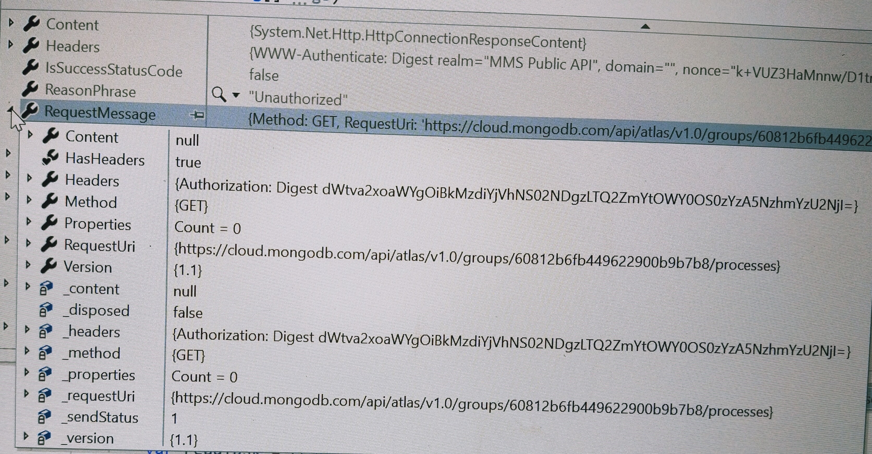

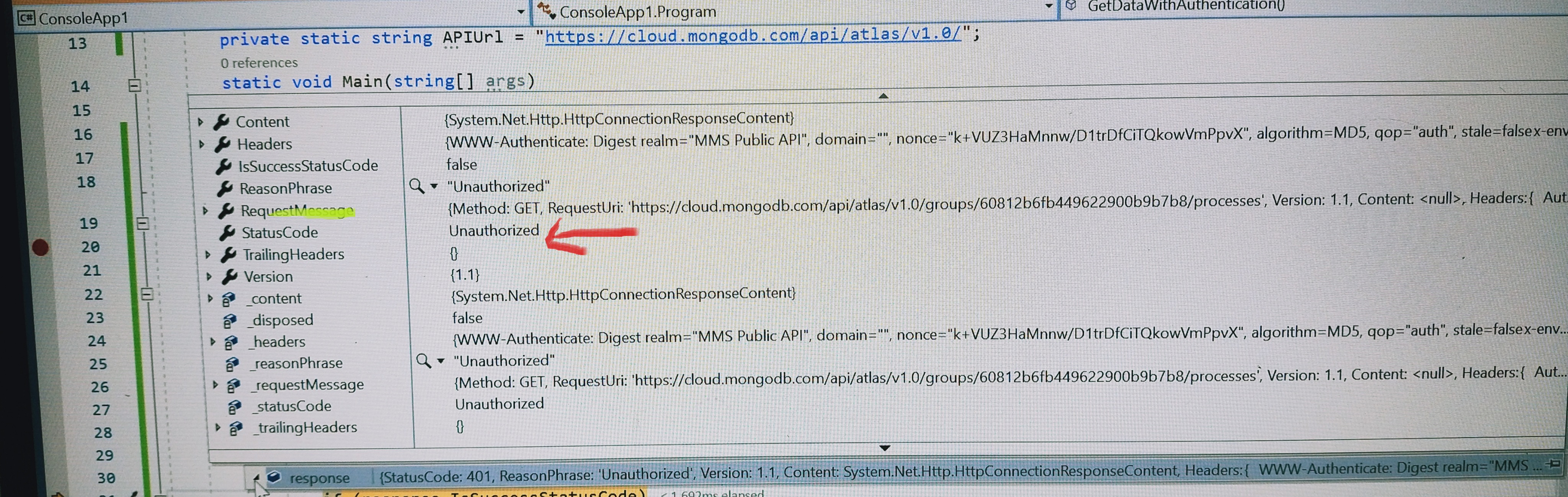

I am trying with project owner only. Find the details of the error in Visual Studio below. In my code I have replaced all the keys & GROUP-ID properly.
I am sharing the RequestMessage body as well below.

Hi @Souvik_Sardar ,
Well this means that the issue is specifically with your c# code.
I am honestly never tried this web method but are you sure the following line places the variable inside the string and not this exact string when encoding:
        var authCredential = Encoding.UTF8.GetBytes("myPublicKeyVal : myPrivateKeyVal");
I am afraid it uses those words as your credentials rather than the parameters.

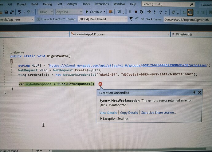

Hi @Pavel_Duchovny ,
Yes issue in code only because I am not sure how I can pass the keys while invoking the API.
While posting the code content in public I changed my keys to “myPublicKeyVal : myPrivateKeyVal” but THESE ARE NOT THE ACTUAL VALUES, in my code I am using the actual public & private keys which was created in Atlas. For you I am sharing the actual keys. The link what you have given I tried that one as well yesterday but that fails with same 401(Unauthorized) error. Find the screenshot below.
Not only this, I have tried with CredentialCache as well but result is same(401). Find the methods below.
