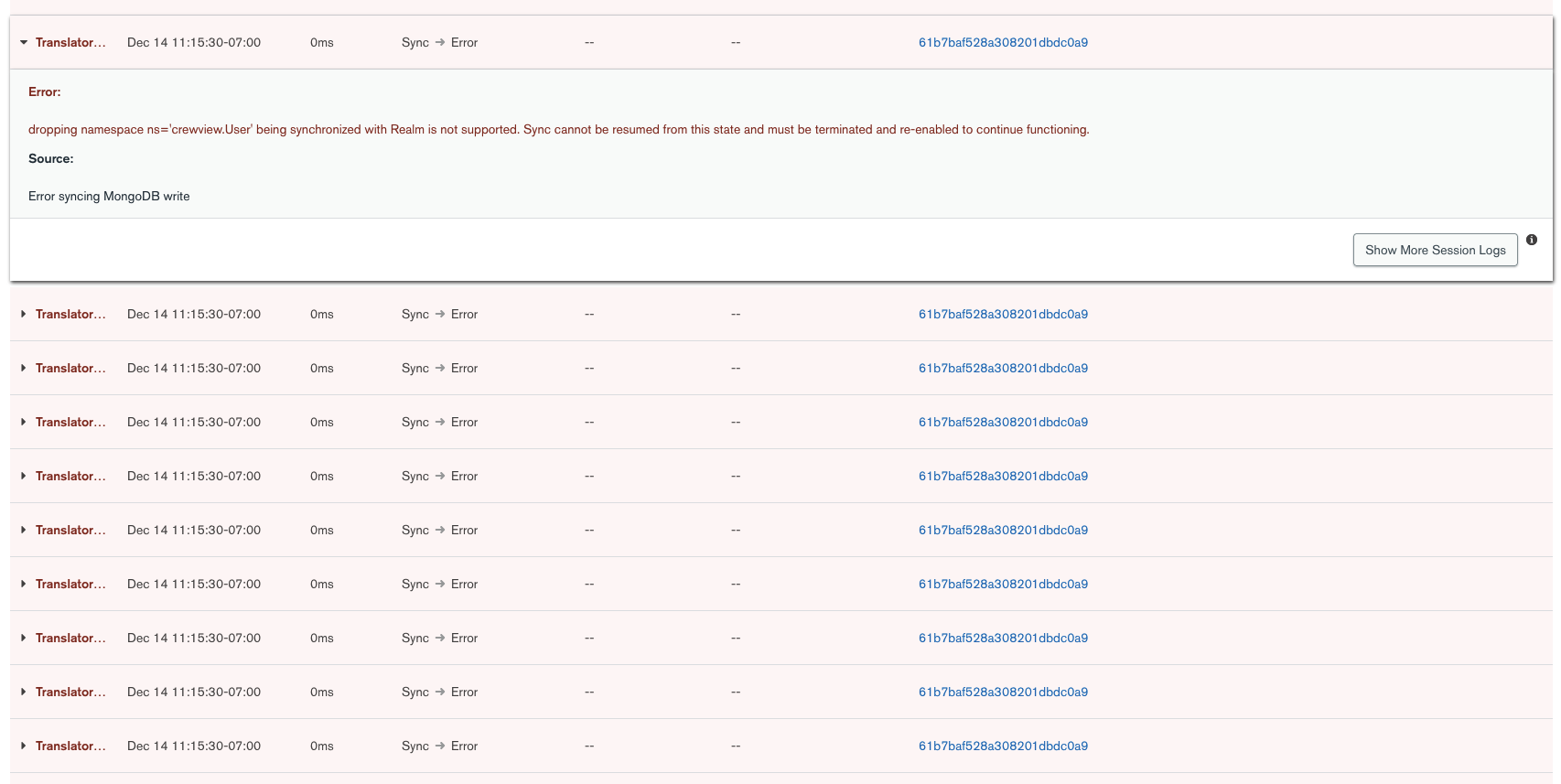

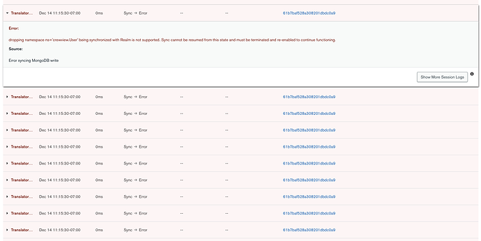

Hey, Brock.
Thanks for getting back to me and thanks for the welcome to the community. I am seeing a bunch of Sync related TranslatorFatalError Errrors. Here’s a screenshot of what I’m seeing.
Funny enough, I’m not getting the error today. Again, nothing in Realm changed on my end. I didn’t disable and re-enable Sync like the message is suggesting. It’s very strange.
