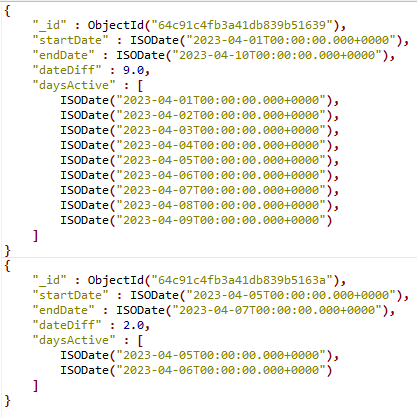

Now the map and range operators blow the days into an array of days each user is active:

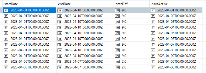

The $unwind turns this into a list of dates that a user was active:

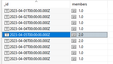

Finally we can group this up, counting how many users were active on each date:

@John_Sewell thanks for that - great answer and just what I needed.
A couple of pointers for anyone else attempting the same:
- dateDiff is used by the $range function and so needs to be an integer - use $toInt or $convert
- The scalar comment for those not following: with the startDate and endDate as date values, the $subtract function gives a result in milliseconds. If you are grouping by day you need to divide by (1000ms x 60s x 60min x 24hrs = 86400000). If you want to group by a different time period, divide by the number of ms. You’ll then need to multiply by the same value when you $map.
- I used $dateTrunc on my startDate to avoid problems with partial days caused by different start times on the same day (otherwise the values for daysActive might not match and you won’t be able to group them). If grouping by a different time period you’ll need to adjust the $dateTrunc parameters accordingly.
