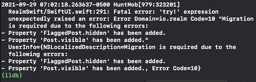

When attempting to run the new version over the top of the old version, I’m getting this error:
It seems from this error that migration is required. I also tried to add

The app loads and runs fine, but when I try to write to a Realm, it throws that error. My assumption is that I will need to provide a new schema version.

@Andrew_Morgan – If it helps, I’ve noticed that the app is also crashing when I dismiss the sheet that has ObservedResults that include one of the models that have a new prop. So dismissing the ObservedResults is causing the crash that says that a migration is needed.
Loading the results is fine. Dismissing them causes the crash.

I threw this together this morning. Original schema didn’t have a state value in the Address object. Added it and it throws the error when dismissing the details sheet.

I think that I’ve found the issue with the mini-app you shared. When a view invokes a SwiftUI Sheet view, that view doesn’t inherit the environment (vs. when you embed a view within a view).
The fix is to add the Realm config to the Sheet’s environment.
Take a look at this branch (it works for me): GitHub - ClusterDB/migrate-issue at fix-sheets
IT WORKS!
I added the realm configuration on any .sheet and/or .fullScreenCover that has a View in it and now it doesn’t crash.
No idea if this is actually fixed and how it should work or if this is a workaround, but thank you Andrew!
