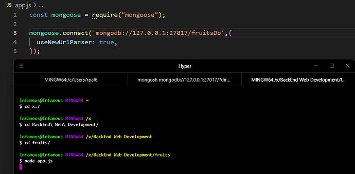

tried it but it gets stuck every time
@Brock Just 2 line script requiring mongoose and connecting it.
I just started learning MongoDb and it’s my first MongoDb project trying to connect with Node.js
It should work with 127.0.0.1
What error are you getting?timeout or someother?
@Ramachandra_Tummala I waited for 5 minutes and it still did not give me nothing it gets freeze

That’s bizarre, it’s working fine on my local environment, there shouldn’t be other parameters needed. The comma is because it’s continuing with the parser.
