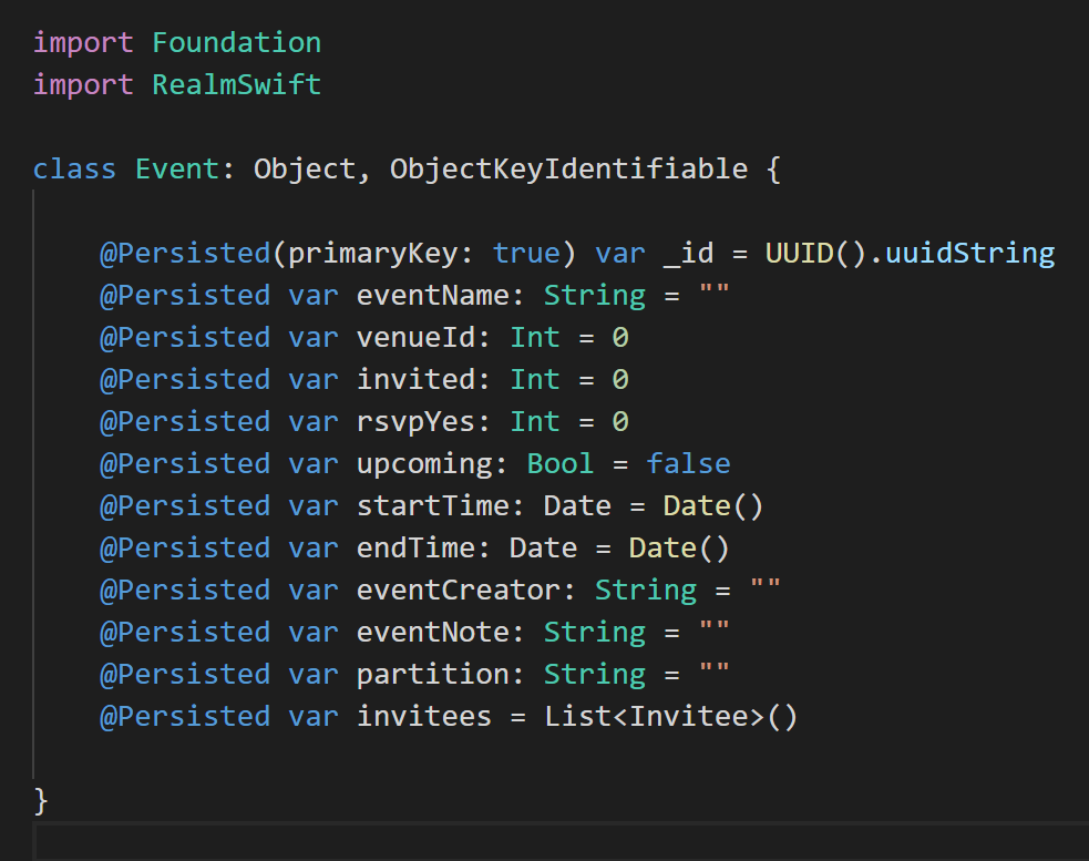

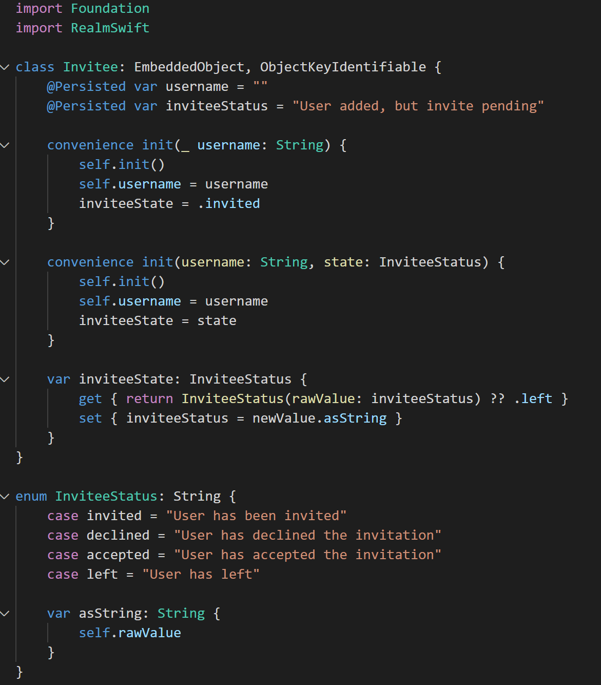

Thank you for your quick response, and all your many articles on using Realm. I would be nowhere without those resources. Here are the relevant object models:
I’m running a function on an Event insert and getting undefined when I look for “invitees” in the fullDocument object. I am sure that this field is being properly added to the inserted object because when I query the Events collection (just a simple eventsCollection.find()) from that same function, the document that is returned DOES include “invitees”
