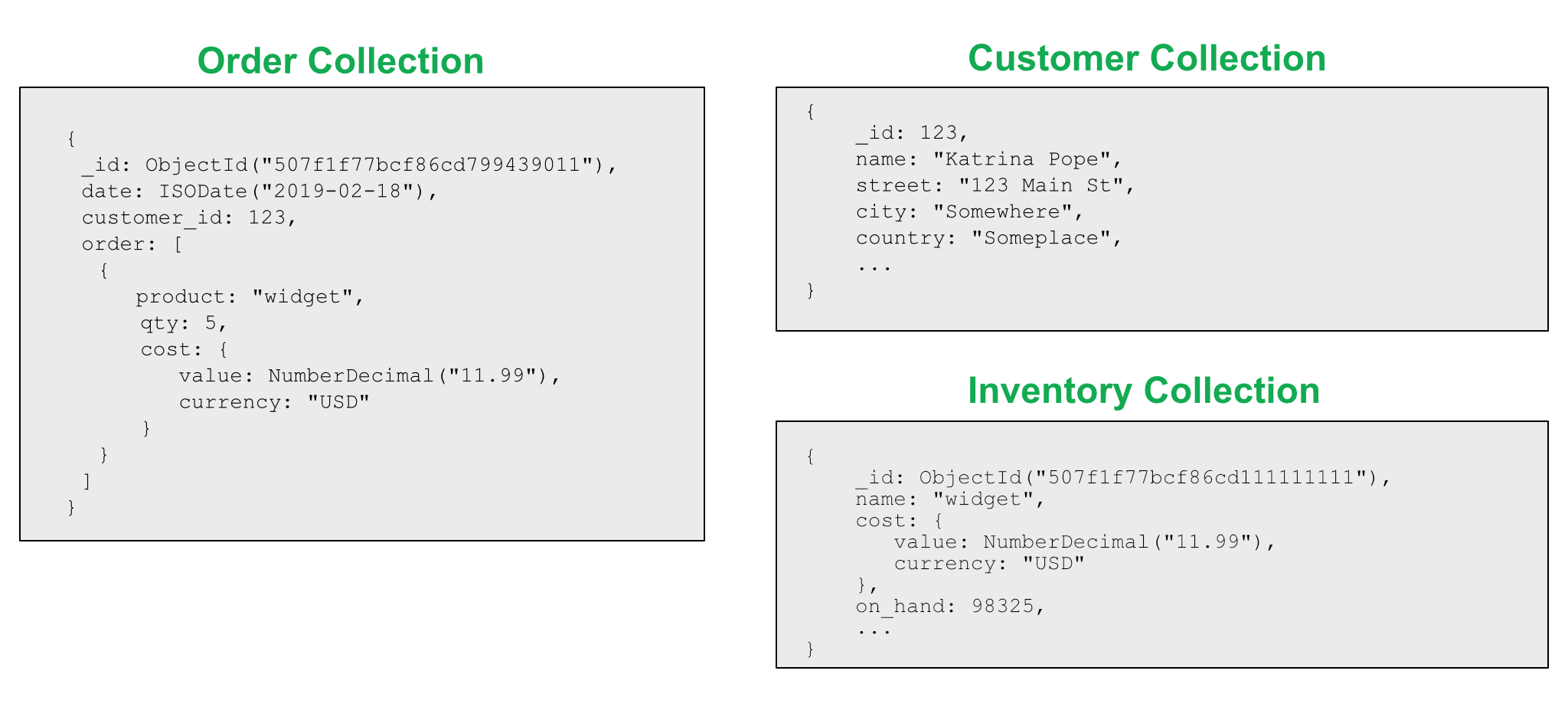

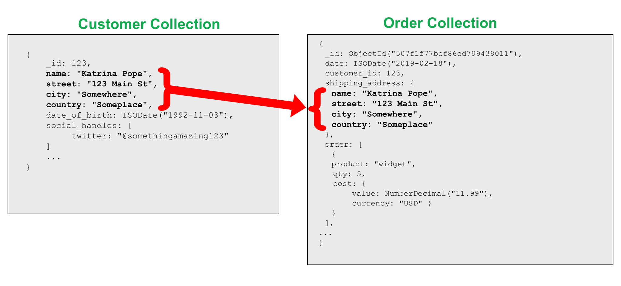

Extended Reference Pattern example
In an e-commerce application, the idea of an order exists, as does a customer, and inventory. They are separate logical entities.
Instead of embedding all of the information or including a reference to JOIN the information, we only embed those fields of the highest priority and most frequently accessed, such as name and address.
By identifying fields on the lookup side and bringing those frequently accessed fields into the main document, performance is improved. This is achieved through faster reads and a reduction in the overall number of JOINs. Be aware, however, that data duplication is a side effect of this schema design pattern.
