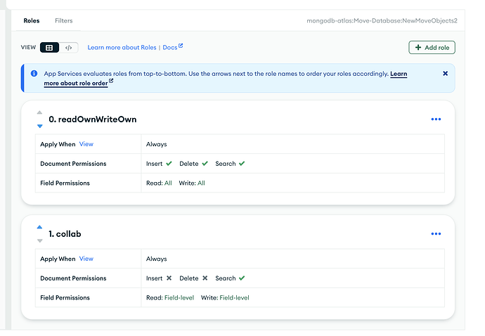

So, as mentioned, when we set it up exactly as described under a single role, it works, but we can only apply 1 set of permissions. When we set it up with 2 roles (ordered as you reference), where we set the owner first (0) and the collaborator permissions second (1), it does not pick up the second set of permissions, even if the user is not an owner of the document (meaning that it won’t trigger the second set of permissions). This is the setup we tried where it didn’t work (same apply where expression - blank).
Setting this up for Role 0 - apply when blank, read/write filters as follows:
      "userId": "%%user.id"
Setting this up for Role 1 - apply when fields blank, read/write fields as follows:
      "invitedUserIds": "%%user.id"
When we set them up separately, however (i.e. only having role 0 and testing with each individually… they work fine). The problem is when we do it with role 0 and 1, where 0 has full permissions as the owner, and the 1 has document level field permissions, search only, no insert, no delete, the documents in the “main” collection don’t return from Realm for the collaborators.
I apologize if this isn’t so clear.
TLDR: When using permissions with 2 roles (role order evaluation) with different permissions for owners/collaborators, collaborators can’t see the collection. Is this due to the specific field level permissions we set by chance? When setting them up individually OR with the $or method as described in the documentation, it works perfectly fine.

For usage in Flexible Sync, a role’s Apply When expression cannot reference document fields. The reason for this is because in Flexible Sync, roles are evaluated at session start (before any documents are looked at), as opposed to on a per-document basis. You can find more information about this behavior here.
The issue with having an empty Apply When expression for both roles is that an empty Apply When expression always evaluates to true. Thus, due to the nature of role order evaluation, the permissions described by the first role will always come into play.
Thus, in this case, for any sync session, the permissions set described by role 0 would always be applied for the course of a sync session. For a user trying to sync, documents that matched the expression:
would be visible to the user, which explains why the collaborators wouldn’t have been able to access even documents such that their ID appears in “invitedUserIds”.

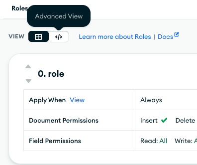

That’s the main reason why I was suggesting trying to incorporate custom user data into your permissions evaluation strategy (this is commonly how I’ve seen other apps setup Flexible Sync permissions in a more dynamic way). Also, if I understand correctly, if you don’t need restrictive permissions on the fields in the document, you could combine both roles into a single role like:
    "name": "role",
    "apply_when": {},
    "document_filters": {
        "read": {
            "$or": [
                { "userId": "%%user.id" },
                { "invitedUserIds": "%%user.id" }
        "write": {
            "$or": [
    "search": true,
    "insert": { "userId": "%%user.id" },
    "delete": { "userId": "%%user.id" },
    "read": true,
    "write": true
(You can see the full JSON view of the role by clicking the “Advanced View” in the toggle in the roles viewer)
Screenshot 2023-08-16 at 6.25.45 PM
As for why this only works if you don’t need field-level permissions – this is because dynamic expressions for field-level permissions is currently unsupported in Flexible Sync.
