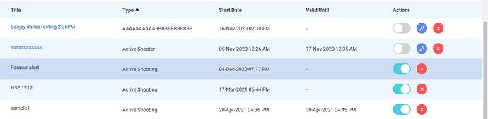

If there are no 10 alerts belongs to the alert type as you told, we should fetch the alerts belongs to the second alert type rt.

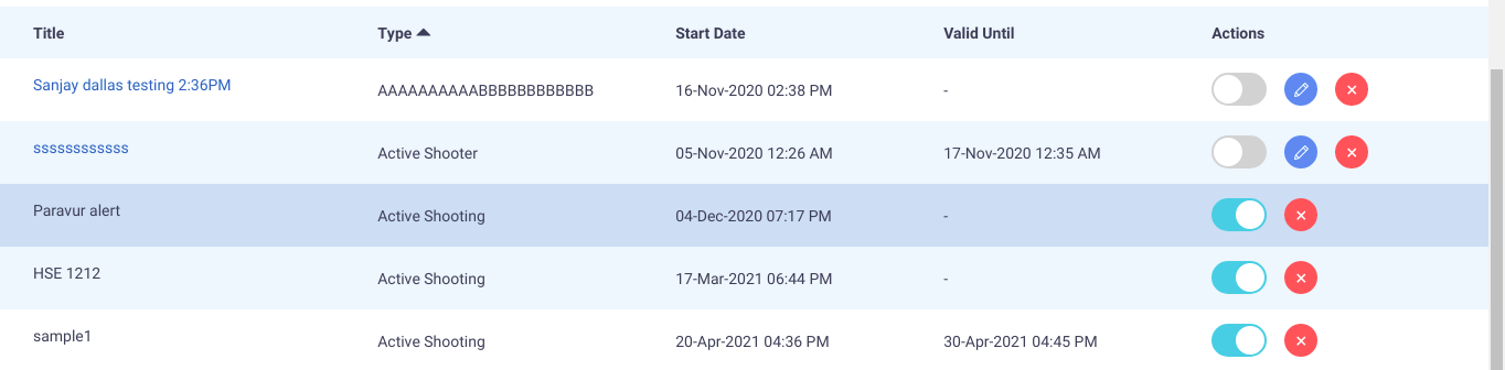

As you can see in the attached image, there is a sortable column called alert type which fetches the alerts based on the alert type name either in ascending/descending order.

I already checked it. And I canât help except to suggest a redesign of the data base.
I suggested a work around for the sort by type. and it looks like it canât work because the database contains some test data.
