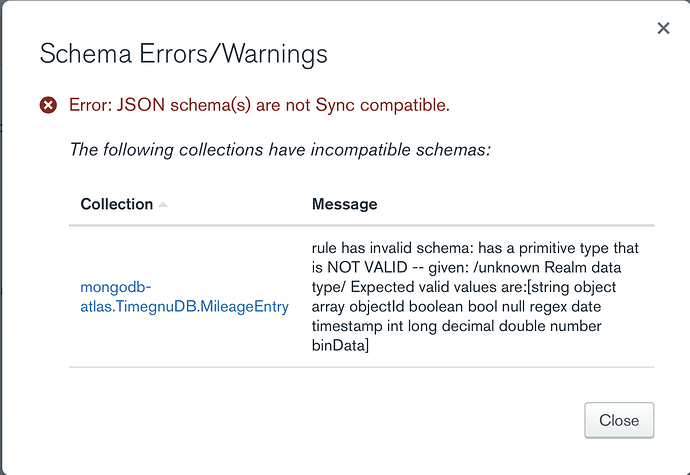

Migration finding #1
It seems that the Realm App does not accept Realm Objects that has “float” data types, even though the documentation says otherwise on https://docs.mongodb.com/realm/dotnet/objects/ and Realm .NET | Realm.
I changed my types from float to double, deleted and re-created the Realm App (I had to do this!), and was then able to continue
I am using Beta 1 on .NET, trying to migrate a system currently in production on Realm Cloud

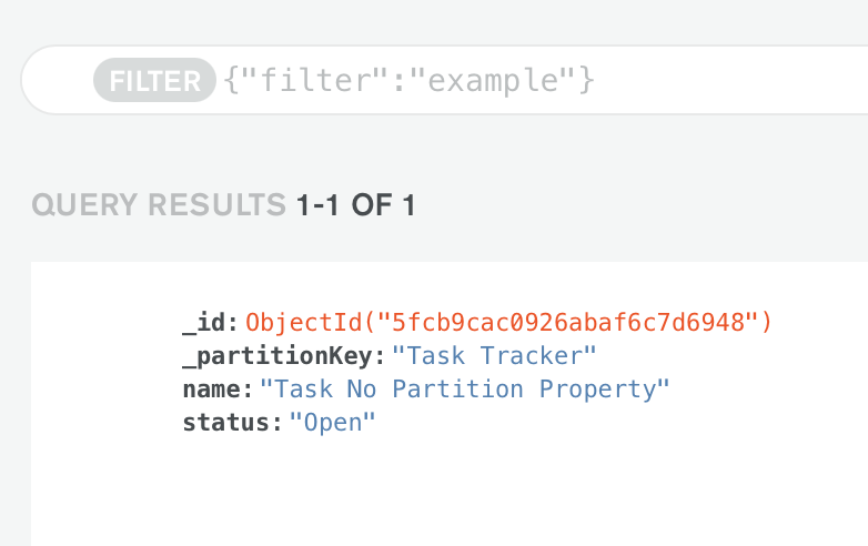

I did the same but doing this will throw exception when save if the Partition is not set explicitly in code. I would prefer the Partition to be inferred automatically when save. Is it possible?
This may not address that question but based on prior posts and our current app, you don’t need to explicitly set the partitionKey property on the object in code. You can actually omit the partition key from the object completely and it will automatically be assigned when written based on the partition key specified when opening realm.
This behavior is not outlined very well in the documentation IMO. For example; this task object has no partitionKey (in Swift)
class TaskClass: Object {
    @objc dynamic var _id: ObjectId = ObjectId.generate()
    @objc dynamic var name = ""
    @objc dynamic var status = TaskStatus.Open.rawValue
and when written to Realm has the required _partitionKey automatically populated
let task = TaskClass()
task.name  = "Task No Partition Property"
and when written

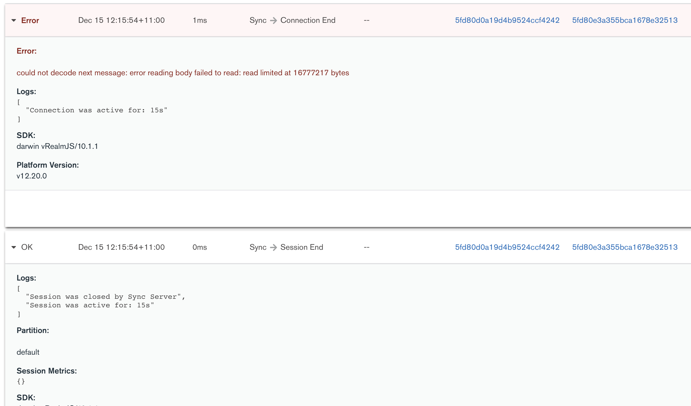

We seem to have run into a problem with the system tables with ‘__’ prefix since they don’t have ‘_id’ primary keys - are these required for v10.1.1. SDK or can we remove these from the v10.1.1 schema ?
Regards

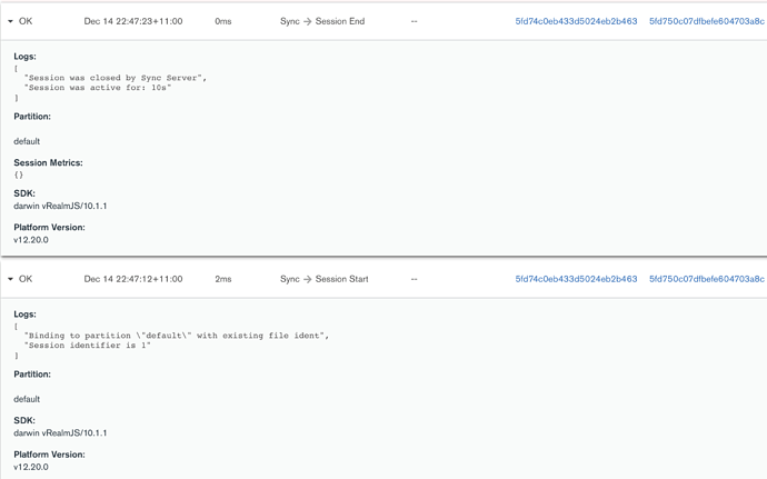

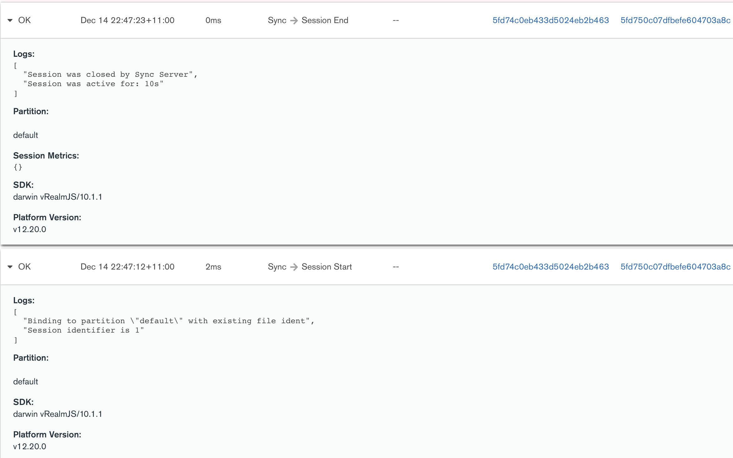

OK I have removed the system tables from the schema and now get past the schema validation and the schema is now appearing in MongoDB Atlas but there appears to be no data in Atlas.
Opening the realm and querying data from the node.js client returns data.
Any idea why data is not visible in Atlas ?
Script below:

There doesn’t appear to be any call to MongoDB via the node.js driver - how are you inserting data into Mongo? This appears to only be opening the realm on the legacy Realm cloud - where/how are you inserting it to Atlas?
I am not using the MongoDB Realm migration guide script here since it does not seem to handle the relationships correctly when data is converted to JSON. The script I modified is the original one provided for migration to Realm Cloud from a local file. I am just opening a synced MongoDB Realm using SDK v10.1.1 instead and then copying the data from the local realm file into the ‘target_realm’.
The ‘source_realm’ is just a local realm file. The ‘target_realm’ is the MongoDB synced realm.
Shouldn’t it be possible to open the new Synced Realm and then add data to the synced realm from the client ? It seems to have created all the same synced realm subdirectories and files on the local machine - the top level directory is called “~/mongodb-realm/appID”.
const target_realm = await Realm.open({

Oh I see - yeah that should be possible. What do the logs say?
Which logs ? On the Atlas portal is just shows connect and disconnect and session start and session end.
The console output from Node.js is as follows:
Enter to quit
> ERROR: Connection[1]: Reading failed: Broken pipe
Connection[1]: Connection closed due to error
Connection[1]: Connected to endpoint '3.210.32.164:443' (from '10.0.1.171:50279')
ERROR: Connection[1]: Reading failed: End of input
Connection[1]: Connected to endpoint '3.210.32.164:443' (from '10.0.1.171:50280')
ERROR: Connection[1]: Writing failed: Broken pipe
Connection[1]: Connected to endpoint '3.210.32.164:443' (from '10.0.1.171:50281')
Connection[1]: Connected to endpoint '3.210.32.164:443' (from '10.0.1.171:50282')

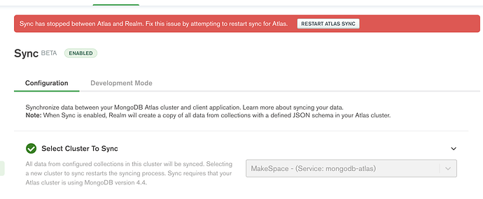

So what is going on here ? Is there some limit on the size of sync data ? If so shouldn’t the sync client create smaller packets automatically ?
UPDATE:
OK I just tried loading a single table using the same script and that data is now showing up in Atlas.
@Ian_Ward is there some kind of problem with loading data using the method I have outlined above if the total amount of data exceeds 16MB ? Even if I break up the write(){} transactions into smaller chunks the sync still seems to be failing. Is there any way for the client to control things so that the sync limit of 16MB does not get exceeded ?
I also keep getting the following message
