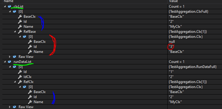

thank you very much for your prompt answer. I ave created a little code that automatically fill up a local database, so you can run it and create your own data. Please have a look to the attached TXT file. Program.txt (2.5 KB)
About my goal, please have a look to the attached image.
As you can see, the “clxList” result shows object with Id=2 plus there is a field “RefBase” that include the one with Id=3.
In the “runDataList” result, in the field RefClx I can see that the object with Id=2 is shown but I would like to see also a “RefBase” that include the one with Id=3, as in the previous result.
I expect that I have to change the data type from Clx to ClxFull, but I don’t know how to do the rest!
Thank you for the information. I understand the problem and your expectation.
If I understand correctly, the output you’re looking for is something like this:
Make a new pipeline that from runDatalookup for Clx by ID and then you unwind it (since the IdClx is single value so I think it’s safe to unwind). Then with that’s in hand you lookup for baseClx and one more time unwind it
(unwind: https://docs.mongodb.com/manual/reference/operator/aggregation/unwind/)
Here is sample pipeline: note: I’m a Python guy so this is Python Driver
