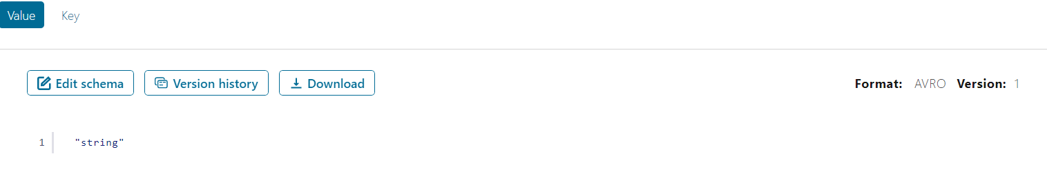

I configured the converters to use the AvroConverter and also gave the credentials for the Schema Registry, however, when I check the Kafka’s topic to which the events are sent, instead of the schema of the change event streams data, Confluent Schema Registry shows me the following schema:

In the current version of the connector the output of the source is always a string so you won’t be able to use the schema registry. However, in the next version of the connector we will support outputting to schema. There is a snapshot build of the connector with this support and demo here. https://github.com/RWaltersMA/kafka1.3. It is not feature complete but should provide some guidance as far as the direction of the connector.
Also, have you considered setting publish.full.document.only=true, this will not push all the change stream metadata to the message only the document itself.
