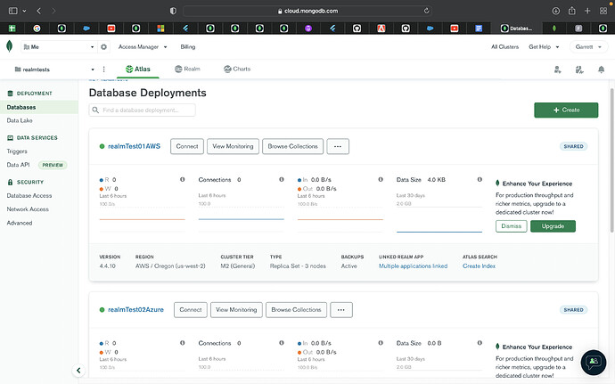

So for starters, just to clarify it doesn’t necessarily matter which PCS (Public Cloud Service) that you use, I would use the one that you feel the most comfortable with. As like I myself, I personally have an M2 cluster in AWS, GCP, and Azure that I have destroyed and rebuilt a few times among others in testing and developing applications.
As you can see:
I will be destroying both the AWS and GCP instances to show you the differences as I go about answering your questions.

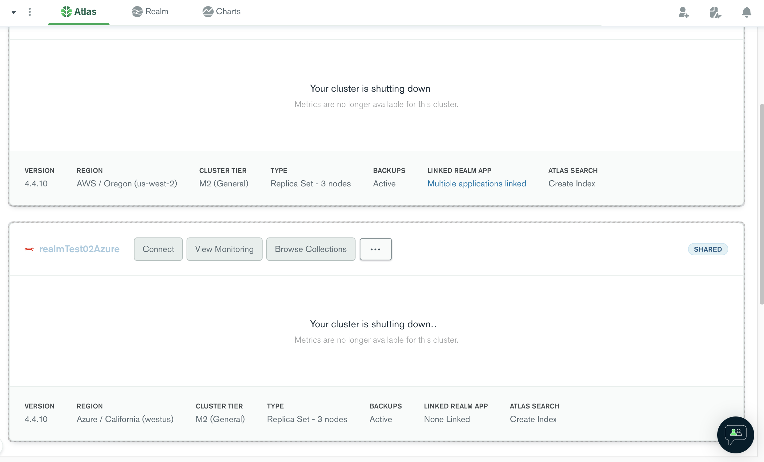

#4. So I want to point out the locations in the boxes, where it says MongoDB 4.4, then location you have one in California (the Azure) and one that’s located in Oregon (The AWS) This is because for these two, I picked the datacenter that geographically make sense to my location.
So now, I’ve destroyed all of my M2 Atlas clusters, so back to your question for 4.

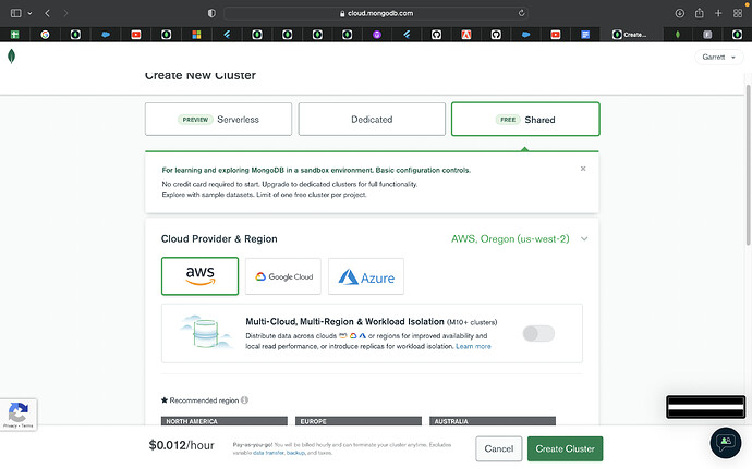

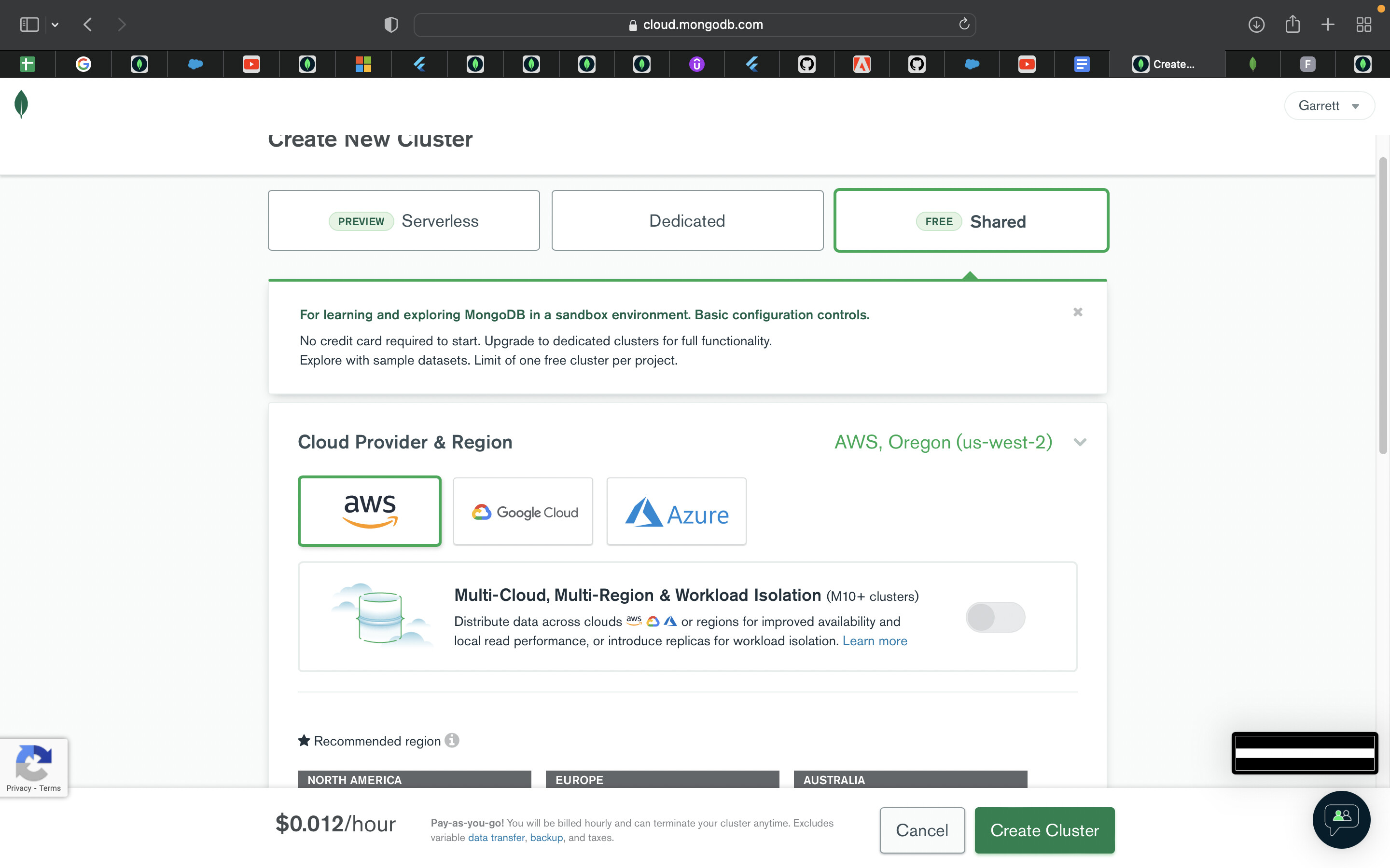

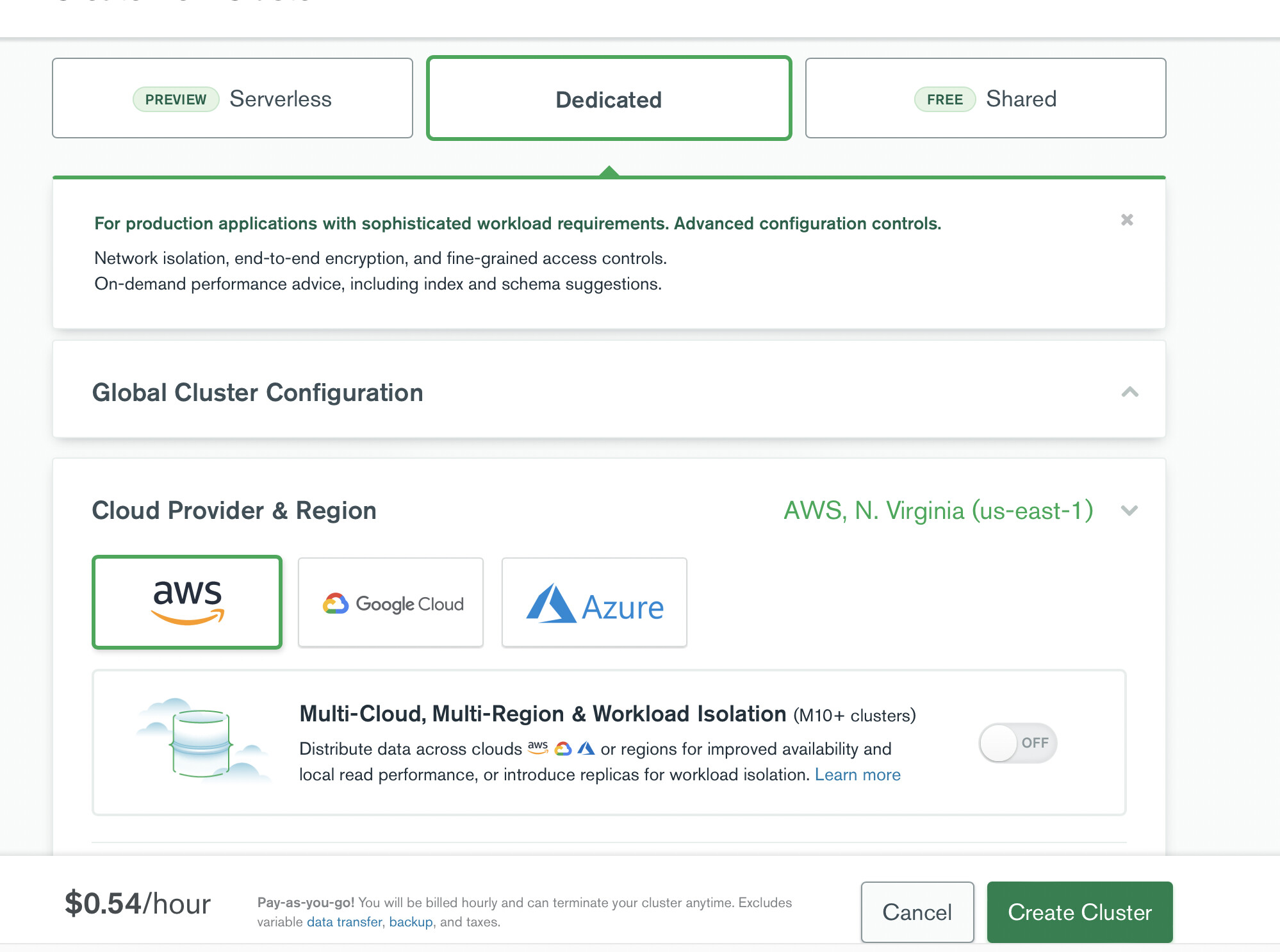

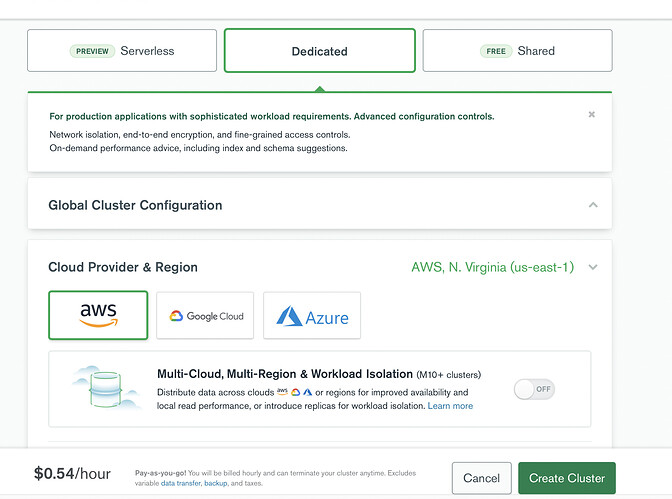

So you’re at this screen, and you can choose server less, dedicated, or or shared. (Free tier)

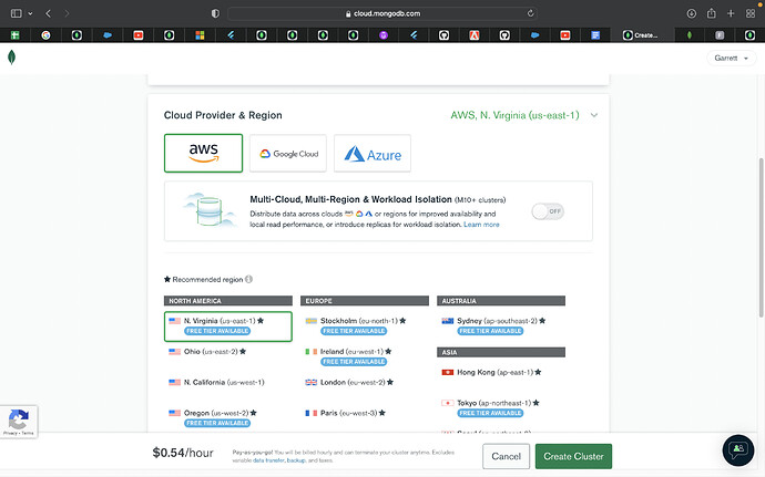

Then, you have “Cloud Provider & Region” this is where you select your exact provider that you want, and what your primary region will be. But do you notice the toggle button?

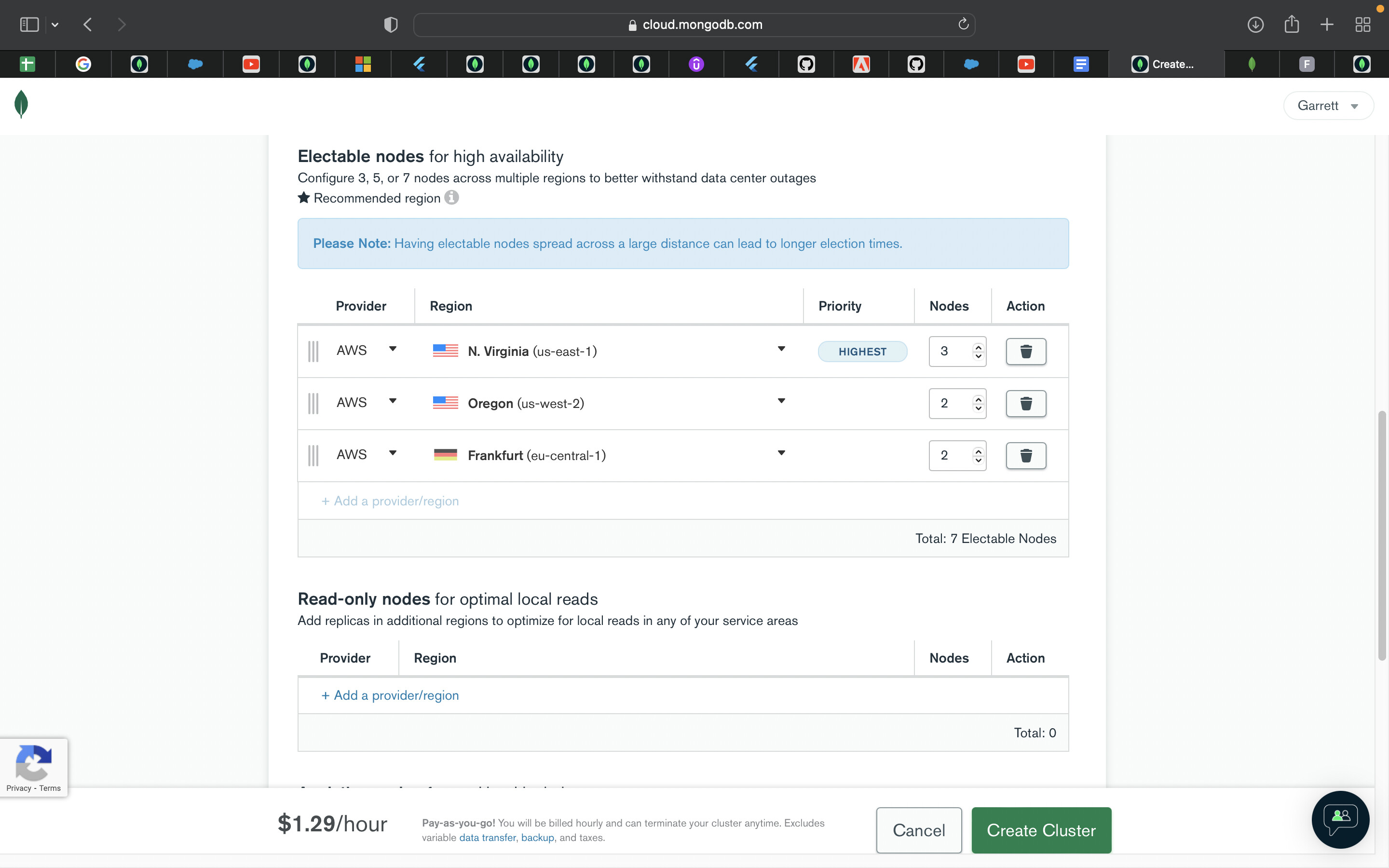

So when I chose AWS in this example, I can pick any single data center I want that’s owned by AWS. I personally choose Oregon as that’s the location that just makes sense to me for my use case. But going back to that toggle button.

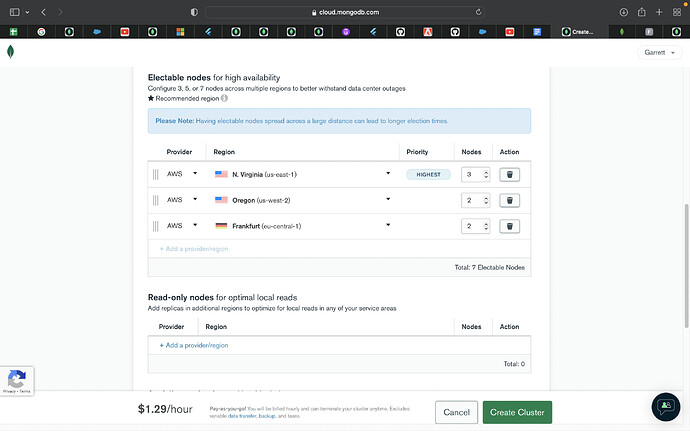

The button I speak of belongs to “Multi-Cloud, Multi-Region and Workload Isolation” - basically just meaning for choosing more areas for more load distributions and minimizing latency for your users. An easy example of this is say East and West Coast of the United States.
For example purposes I also chose Germany to highlight that. Do you notice on the Provider list it says AWS? Well you’re not restricted to just one provided in this relation, as you can also select GCP or Azure and choose any of their datacenters they have available.

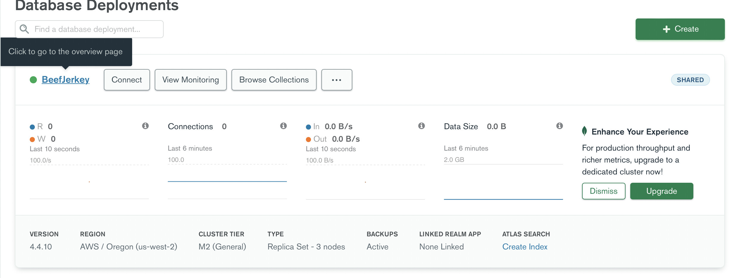

Now, because for me I am just making a test cluster for testing Realm Apps. I chose an M2 cluster via the Shared section. (Remember, only M10+ aren’t on shared tenants).
I chose
Now one thing to consider about this, is by doing this route you lose the abilities to enable business intelligence, or use your own encryption keys. So if you want those functionalities, you will have to choose an M10 cluster. (M20 is the minimum I personally would recommend for a production environment, this is not official, but as stated before, scale by the means of what makes sense for your use)

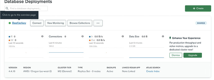

So now the cluster is created, I then click the link to access the cluster.
So this is what you’ll see:

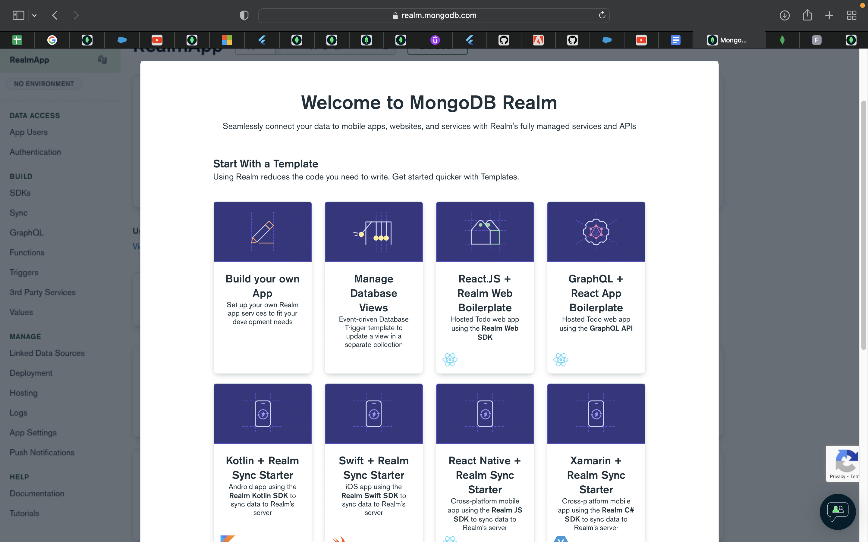

So at this point, to answer your question where Realm comes into all of this, now we set up the Realm app. So you click on the Realm Tab between Atlas and Charts, and you’ll come to this page:
And I chose the “Build your own App” choice.

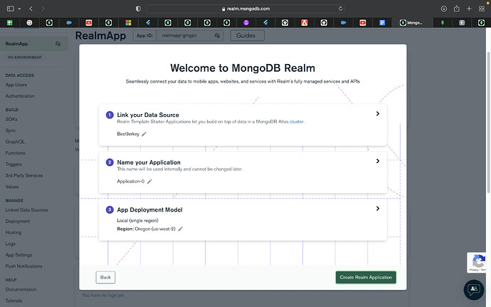

Where it then makes sure you have the settings that you want:
After this screen it goes over what guides will help you and so on. From this point you just worry about your app and how you want it to be setup and made from any of our SDKs.
