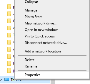

First install the MongoDB database tools from here.
Then add “C:\Program Files\MongoDB\Tools\100\bin” to your Path environment variable like this:
  1. image
3.
4.
5.
6.
7. click save

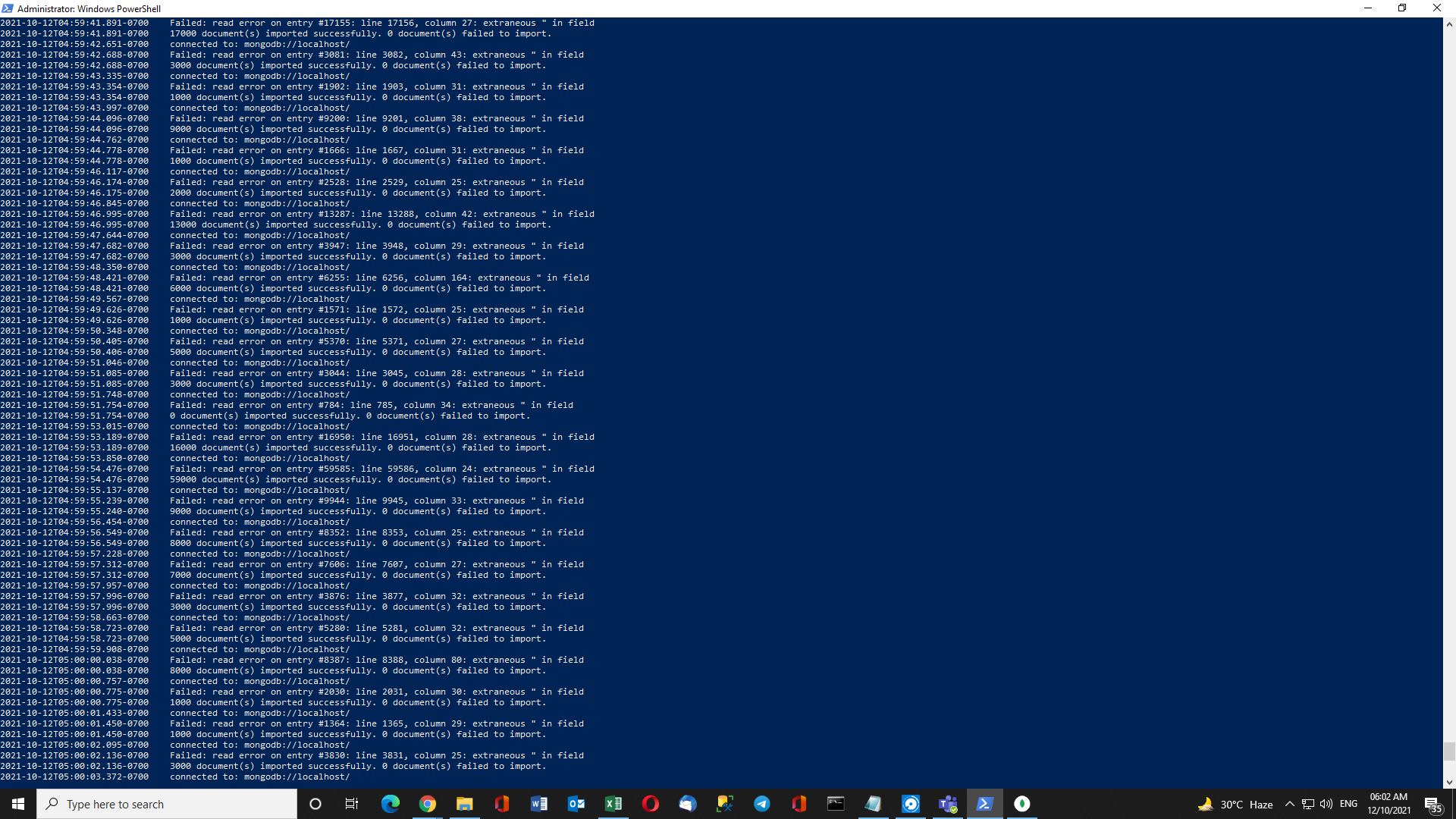

Hi @Rafael_Green,
When I tried the above command on my data but all records were not inserted in DB. I have 1800+ CSV files and this file contains millions of records.
Can you please guide me with a solution?
Here is the screenshot
Thanks in advance
You have read errors on your CSV files.
The error message indicates some extra double quotes on some fields. Make sure you sanitize your input files by correcting the errors. You have the line and column numbers of each error as part of the error message. You will have to edit each file and correct the errors.
