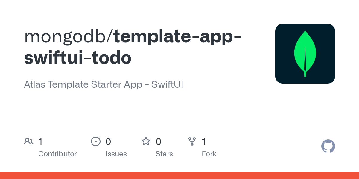

Those instructions are in the README of the template app, see here:
The template app actually downloads with the correct values set in the plist file, so this step was just confirming the values are correct; I didn’t actually have to change anything.
Ah - yes, I see. A little different approach than what’s outlined in the guide but the result is the same.
