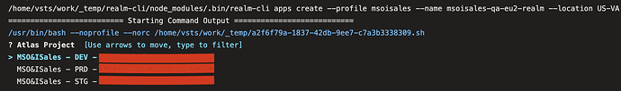

The problem is whenever we try to using realm-cli push or realm-cli apps create command in the DevOps pipeline we get the following message
We do have 3 different atlas projects for each environment. Obviously, we can’t interact with the automated deployment in the cloud. Thus, we need a way to specify the project ID in which we want to create the app.
However, I couldn’t find that option either in the realm-cli push or in the realm-cli apps create command.
So, how I can set the project ID when creating a new app?
I made a shot in the dark and just added --project "MY_PROJ_ID". It worked!!! Obviously, you need to update the documentation guys, it’s frustrating I had to spend so much time and “guess” the answer in the end!
