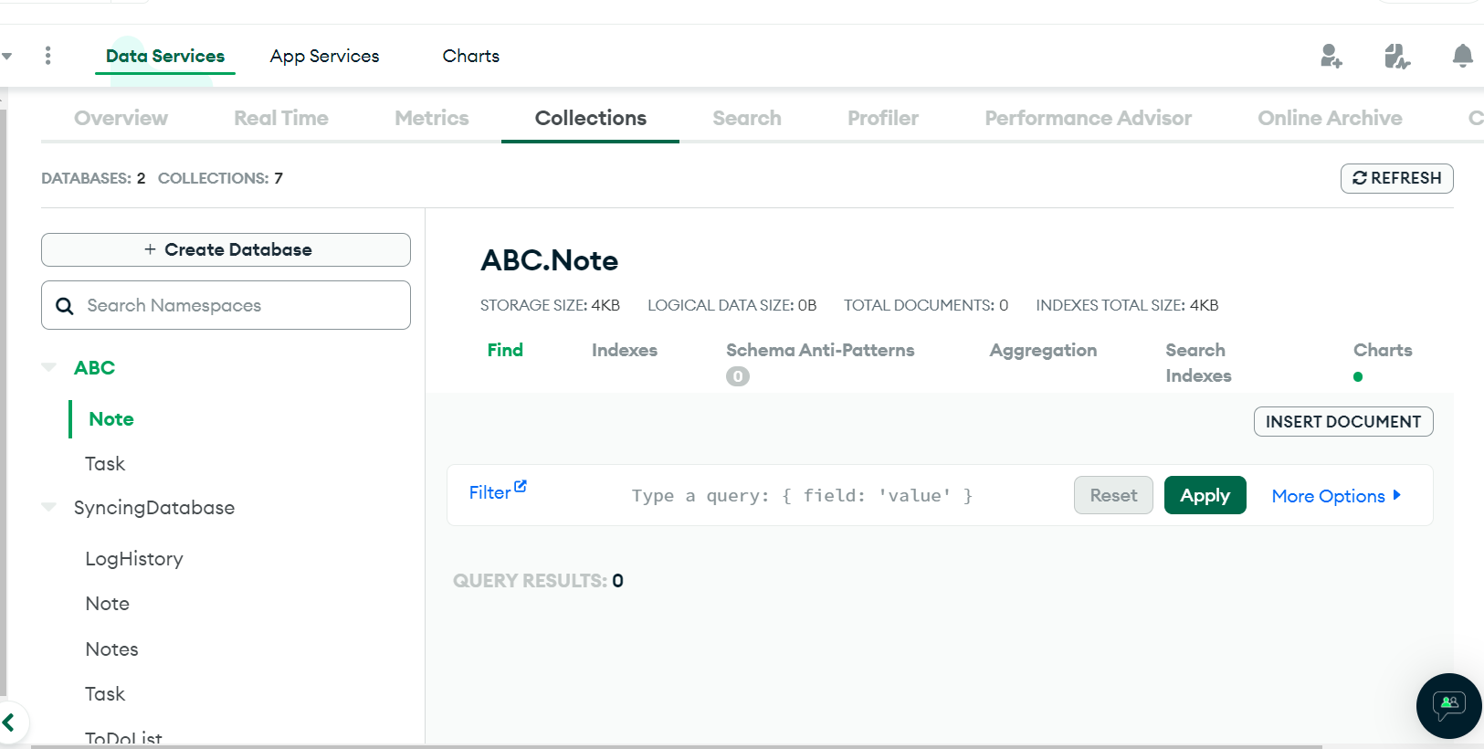

But I still can not see AuditEvent collection in under Data Services tab. I’m using below code for enabling recoding and configuratin:

But still I can not see the AuditEvent collection under DataServices tab in Atlas. I’m attaching some screenshots for your reference.
. also I want to add that I’m using free version M0 of Atlas sync.
The example code you’re using from the documentation has an arbitrary partitionValue and EventConfiguration which may not match how your App Services app is configured.
  • In your Device Sync configuration, are you using Partition-Based Sync or Flexible Sync? What rules are you using for data access?
  • In your App Services logs, do you see any error messages when you try to write to the synced realm?
  • Are you able to confirm that the objects you’re writing to the synced realm are syncing? If you’re creating Task or Note objects in the app where you’re trying to use the Event Library, do you see those objects synced in Atlas?

Ahh, then it sounds like the user configuration you posted above isn’t getting used at all.
This example from the docs initializes a Sync configuration for Partition-Based Sync:
let eventSyncUser = try await app.login(credentials: Credentials.anonymous)
var config = user.configuration(partitionValue: "Some partition value")
config.eventConfiguration = EventConfiguration(metadata: ["username": "Jason Bourne"], syncUser: eventSyncUser, partitionPrefix: "event-")
If you’re using Flexible Sync successfully, then this configuration isn’t getting used at all. This EventLibrary configuration example builds on the example in the docs of opening a Synced Realm for Partition-Based Sync. If you’re using Flexible Sync and the objects are syncing, you’ve probably got something like this configuration somewhere else in your codebase:
var config = user.flexibleSyncConfiguration()
The .flexibleSyncConfiguration() opens a realm for Flexible Sync, and the .configuration(partitionValue: [YOUR PARTITION VALUE]) from the Event Library example opens a realm for Partition-Based Sync. Those two things don’t work together. If your App Services App uses Flexible Sync and you are successfully syncing objects, then the Partition-Based Sync config you’ve pasted here isn’t getting used at all and that’s why you’re not seeing the AuditEvent collection in Atlas.
I’ve just confirmed with the Product team that the Event Library does not work with Flexible Sync, so this functionality isn’t currently supported.
