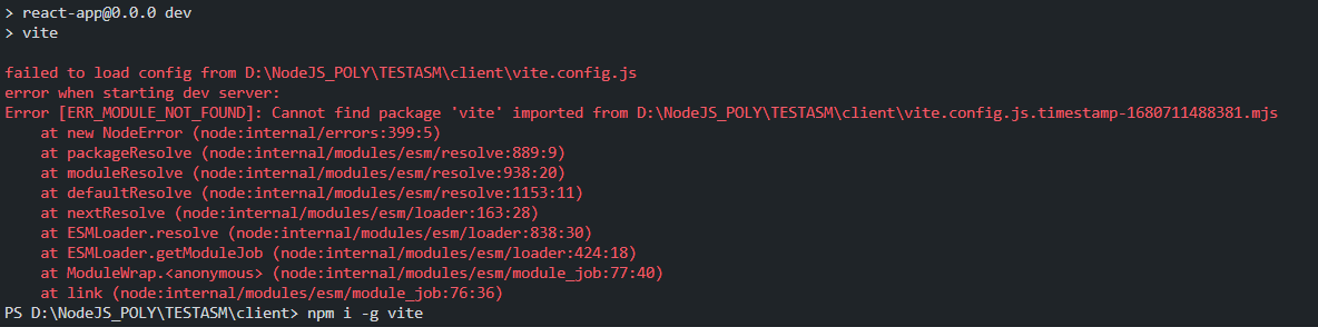

How to fix this so I need help?
Hello @Hung_Viet,
I don’t think this is related to MongoDB.
If you can read the error carefully it says “The package ‘vite’ is not found”, which means you have not installed the ‘vite’ package, can you try installing it?
sorry for not mongo related but this is the best help community i know. i tried installing vite but the node_module folder is not showing as it should.
