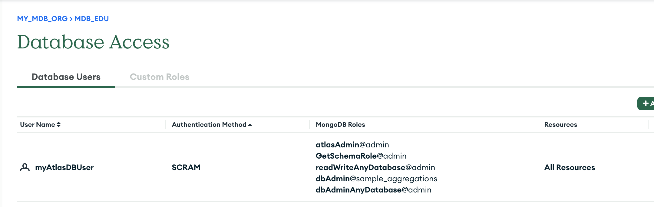

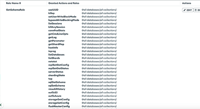

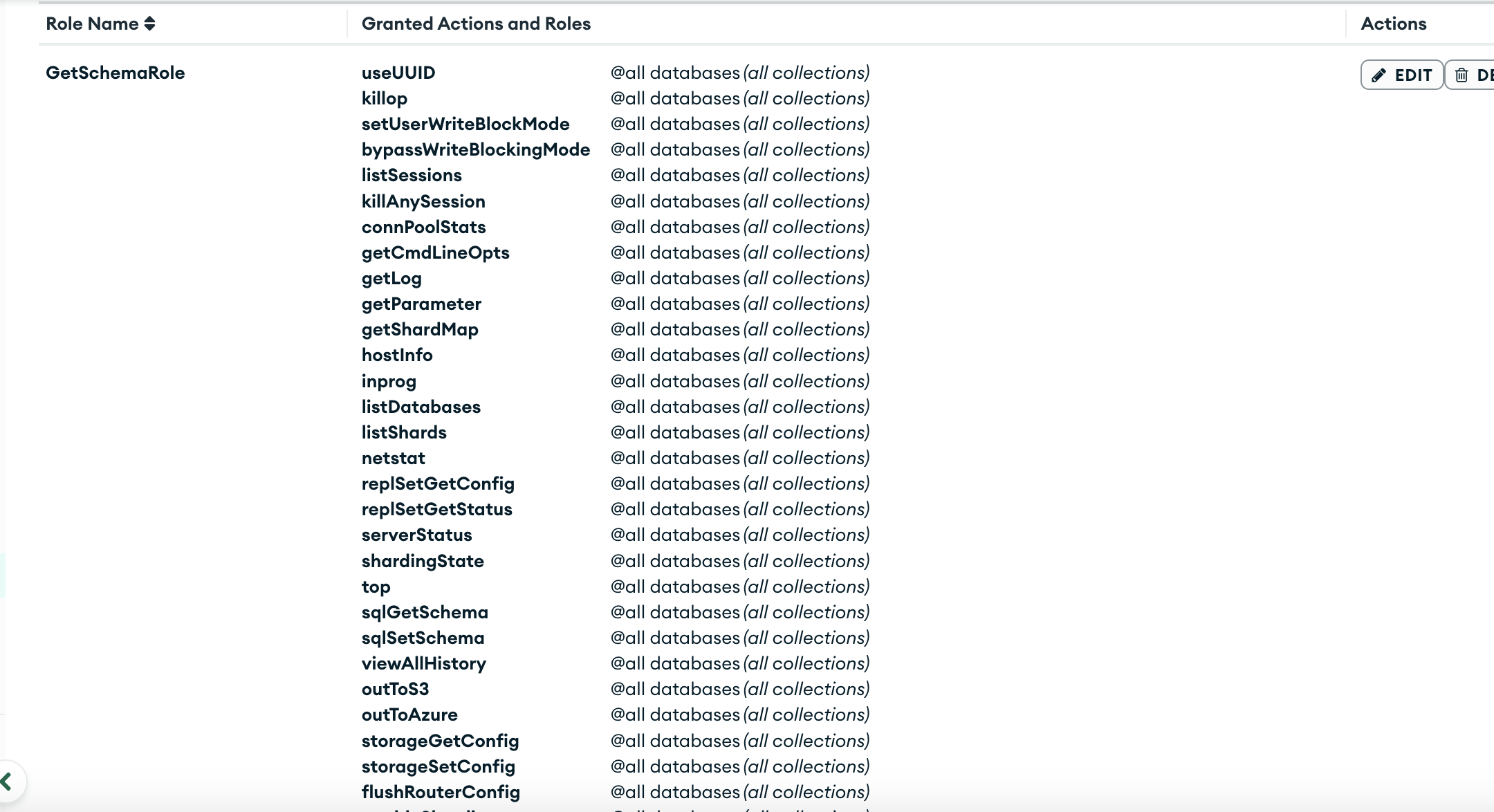

hi - I wanted to view the JSON schema associated with a collection. I poked around the documentation and tried ``sqlGetSchema` command, but I get an error “Command not found”. I did set up roles and assigned the role to my user profile in Atlas. Interestingly enough, I could not find this command in Mongo 7.0 documentation . Is this command deprecated? How do I view a JSON schema?
