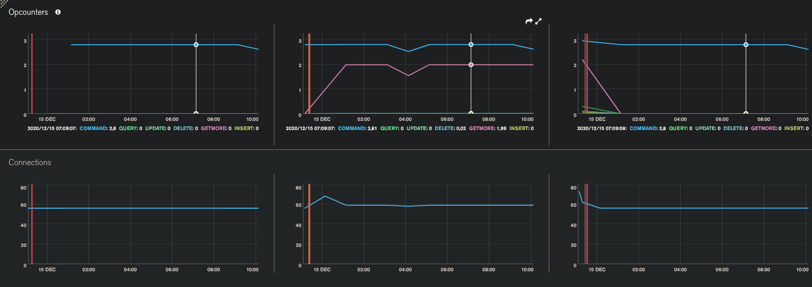

High number of connections and opcounters without anyone using the cluster
The screenshot shows a period of 0 users on an Atlas Cluster linked with a MongoDB Realm app. As you can see, the second shard shows ~3 commands and ~2 getmores per second with ~60 active connections, and the other two shards maintain the same amount of commands and active connections as the second one, even though they have 0 of any other type of operation. This behavior is constant, the command operation never gets to 0.
Is this considered normal behavior for a cluster linked with Realm?

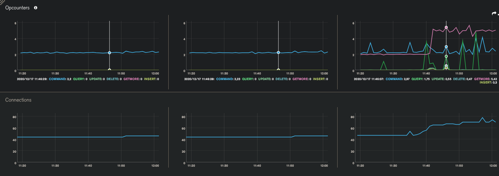

Now, this second image shows a period when some users (less than 3) start using the cluster by a MongoDB Realm Sync .NET client. Should the getmore operation go to ~5.5 per second and stay there constantly? And should the active connections go from 47 to 70 with 3 users connecting?

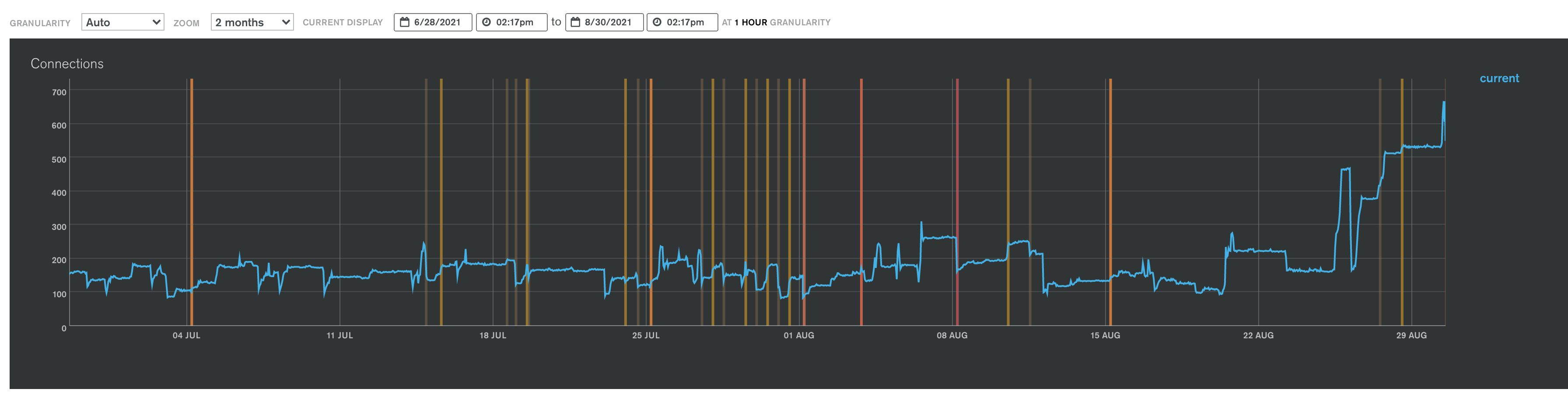

I noticed something earlier today about growing connections which I put into this post: Realm does not seem to close mongodb connections on app redeployment

Do you have any updates about the connections? I’m having something very similar on my App. Every time I run some function on the realm app, I’m observing that it increases the number of connections; a single client is consuming 140 connections.

The response I received on August 9th was:
We believe that this issue might be related to changes that were introduced last week in MongoDB Realm. We cache MongoDB client connections in a resource pool on each of our servers (to prevent the creation of new connections for every DB request), we made some internal adjustments to how we cache these connections, like when they are evicted, etc. that resulted in additional connections being created unnecessarily.
Later on the 12th I received an update:
Thank you for your patience. It seems that the latest MongoDB Realm has incorporated the changes required to close idle connections.
My connections have dropped from the peak of 700s down to around 178 now. 178 is still extremely high for the number of clients I have (including triggers); but it seems to be holding steady and isn’t a red alert issue for me anymore.
Maybe Realm just likes to keep a connection pool of ~150+? I’m pretty new to mongo so I don’t really know how it works or optimizes that – I did see one stack overflow post that implied 1 connection really turns into 4 connections on a standard 3-database replica set. :woman_shrugging:

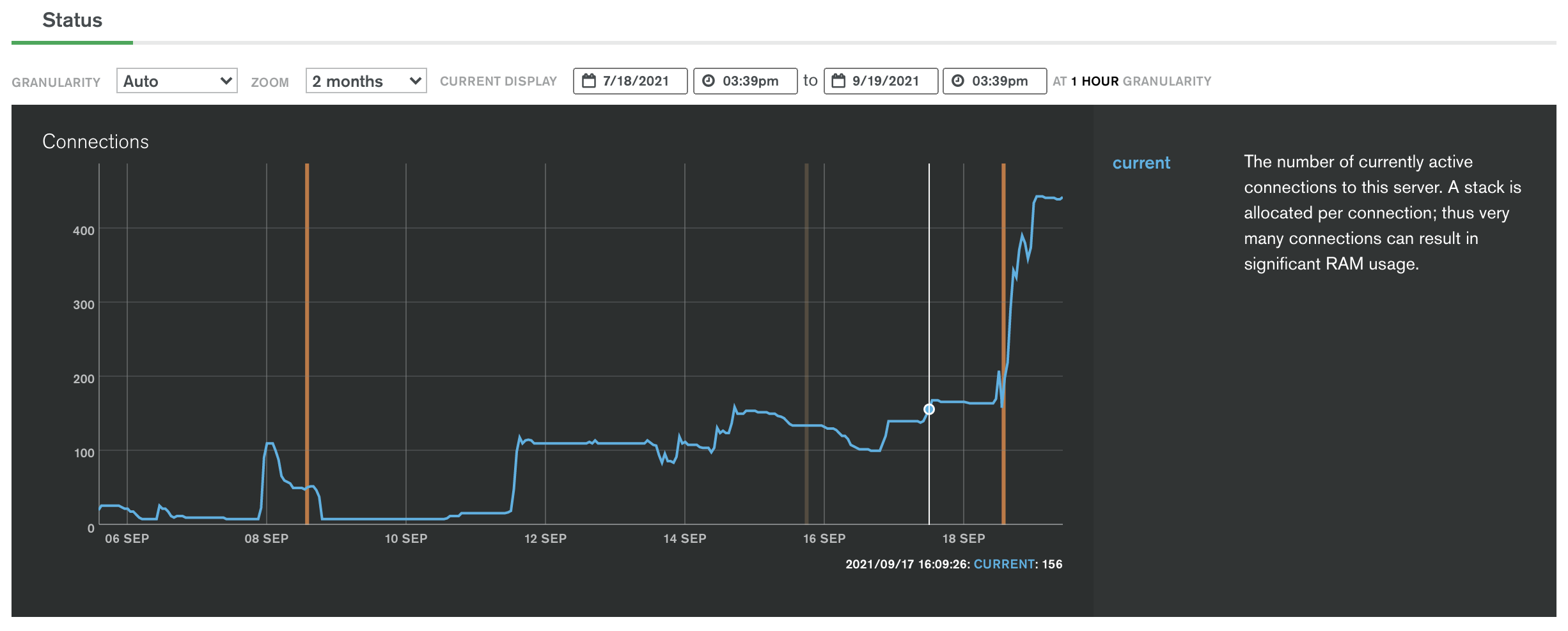

It definitely looks like this is still an issue. One of my realm apps is now consuming 400+ connections, and it keeps increasing with every new deployment via github.

I’m having what seems to be the same issue. I’m relatively new to Realm and MongoDB and still learning the platform. As such, I only have one or two test clients running at a time and the app has only 3 very small collections to sync with.
Today, I received numerous email alerts for getting close to the 500 connection limit when I know there hasn’t been a connected client in over 12 hours. Currently it’s showing 400+ connections and I haven’t connected an app at all day. All of this seems like something new since I’ve been playing with Realm for weeks up until without receiving these alerts. At any rate, the # of connections never seems to really go down.
I’m seeing this issue myself, and have two Realm apps eating up about 450/500 of my connections – at least, that’s what I’m thinking since it seems to hover at that level even with a solid hour of having nothing set in the NACL.
