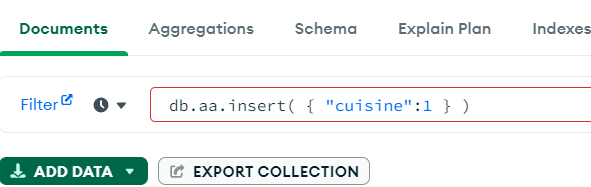

I try to create automatically a database from Compass
use db1
db.col1.insert( { "x":1 } )
2 questions :
1) is it the good process to use the "Documents" menu and to do "ADD DATA" and "Insert document"?
2) I yes, when I run the query, I have the message "Insert not permitted while document contains errors."
Could you help please?

What you have pulled up in the screenshot is the query bar in Compass which can be used to filter documents based on specified criteria. You can find more information on how to use that query bar to find specific documents here: https://www.mongodb.com/docs/compass/current/query/filter/.

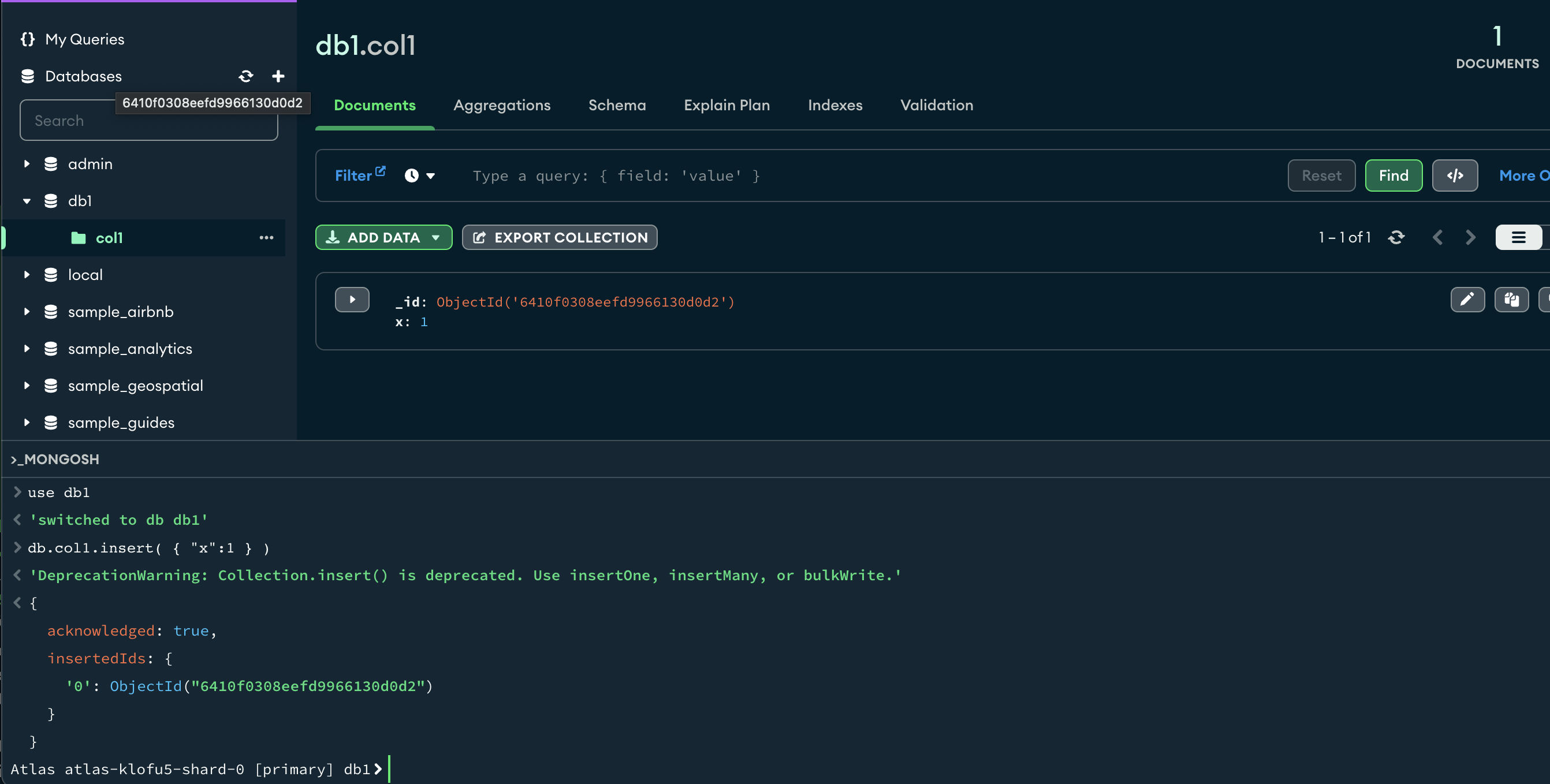

Unfortunately, the query bar cannot be used for inserting documents. However, you can run those 2 commands in the embedded shell (mongosh) in Compass to add a document to db.col1. Once you run the commands in the embedded mongosh, you can click on the refresh button next to “Databases” to see the data you added via the embedded mongosh in Compass. I have attached a screenshot of what this should look like for your reference.
