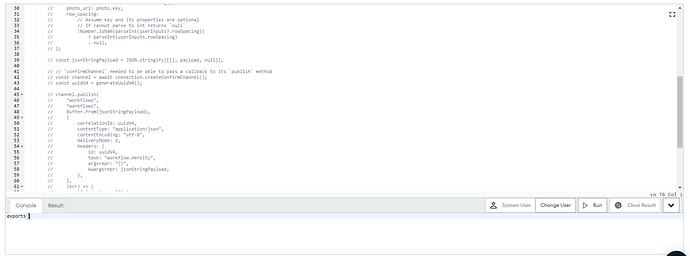

I’ve tested this function using the console provided below the function editor in App Services UI (see below picture). But I was able to also reproduce this behavior when calling the function using a trigger.

Here’s what the function returns after like a whole minute (displayed in the result section in picture below)
> ran at 1669737017608
> took
> error:
Error: write after end
