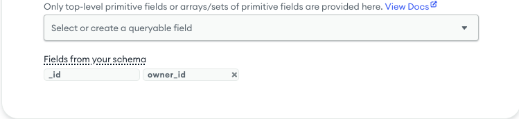

And this is in my queryable fields:

I was able to fix it, but the issue was that I had ownerId in my local models, changing that to be the same as the json in the rules fixed the issue, so I put owner_id in my models and everything is working good now.
