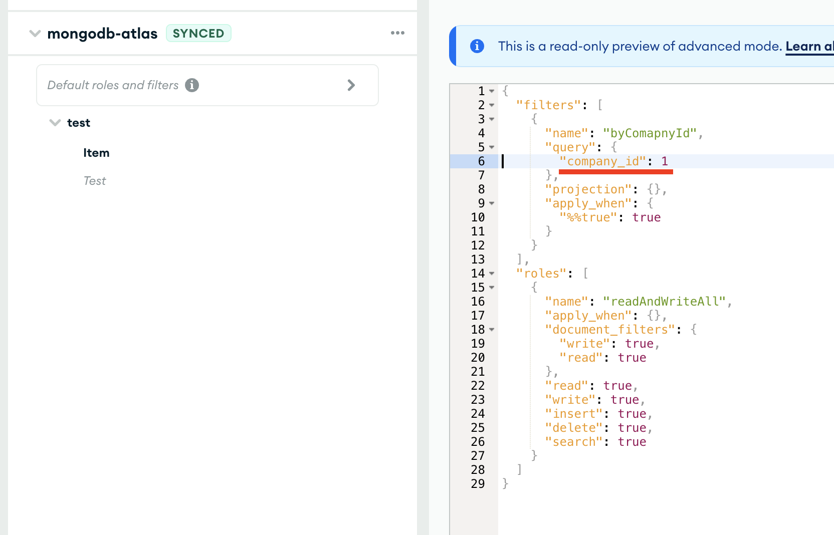

To keep things simple, I’ve set up an Atlas App with anonymous authentication, as well as a filter on the Item collection to only return items that have a company_id: 1:
However, when running the app, Atlas is not applying the filter when the Realm is first initialised. I’ve created a simple app to demonstrate what it looks like in this gist, it also includes a screenshot showing that Realm is pulling through all the items, and not just the ones for company_id = 1.

(Request-level) filters (the list of objects in the “filters” blob) are unsupported in flexible sync. I would recommend trying to use the document_filters field in the role configuration instead to achieve the permissions scheme that you are describing above:
"document_filters": {
   "read": { "company_id": { "$in": "%%user.custom_data.companies" } },
   "write": { "company_id": { "$in": "%%user.custom_data.companies" } }
Side note - I believe this suggestion will only work if the companies array in the custom user data is an array of _ids as opposed to an array of objects. Also, this will require adding company_id as a queryable field in the sync configuration.

Thanks for your reply, I’ve tried your suggestion though it looks like it’s still not working. I’ve set the filter to company_id: 99 but it’s still returning all the items.
In the Atlas App Services rules system, write access implies read access. So in this role configuration, the "document_filters.write": true implies both read and write access at the document-level for all items. If you want to restrict both write and read access to only certain companies, you’ll need update the "document_filters.write" expression as well. For the example of "company_id": 99, it should look something like:
   "read": { "company_id": 99 },
   "write": { "company_id": 99 }
Let me know if that works for you,
Jonathan
Thank you very much Jonathan, that did the trick!
