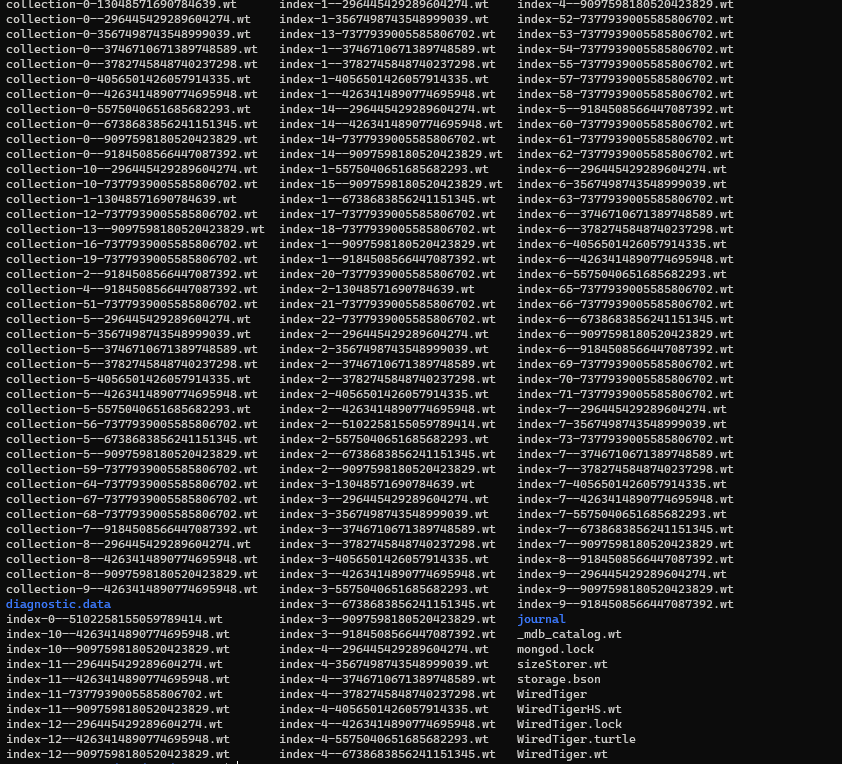

I don’t know if the material has been deleted, or it’s simply impossible to access it, but in the /var/lib/mongodb folder I have the following material:
Apparently, from what I understood, these are database materials, I thought that if I deleted mongodb and reinstalled, and then put in the materials that were then it would be backed up automatically.

I would really appreciate the help. I’ve already tried to ask in several forums, no one has a clue. Or no one has the power to help.
I have very important materials in it.
Thanks in advance!

From this log I understand that it moved to the wiredtiger filesystem, but I have no idea why, and since then it has been completely screwed up…
Look like wiredtiger can’t recognize the data file. Maybe data corrupted, or incompatible format, whatever.
If you don’t have critical/important data, (or if you have a full backup), you can try deleting the db files and start from a “clean state”
I don’t have a backup, what I do have is the files of the db that I copied from /var/lib/mongodb after it was knocked out…
My question is why did it happen, why did it get screwed?
The data is very, very important!
There is a difference between starting mongod with and without config file
In your first screenshot you have started mongod issuing just mongod
This brought up your mongod successfully on default port 27017 and default dirpath /data/db
It appears to be hung but it is not.Since your mongod was started on foreground (without fork) the session appears to be hung but log clearly shows waiting for connections
You have to open another session and connect by issuing mongo
But above is not what you want
Your data was in /var/lib/mongod
Second attempt you tried starting your service but there is a mismatch in your config file and the data files that are existing in your dbpath

in initAndListen: Location28662: Cannot start server. Detected data files in /var/lib/mongodb created by the ‘wiredTiger’ storage engine, but the specified storage engine was ‘mmapv1’., terminating
2023-06-06T19:20:15.754+0200 I NETWORK [initandlisten] shutdown: going to close listening sockets…
All files ending with .wt are WT files
Why the storage was changed to mmapv1 if the .wt files already existed in the dbpath directory?
comment/disable this parameter in your config file and enable wiredtiger and see if you can start your mongod
